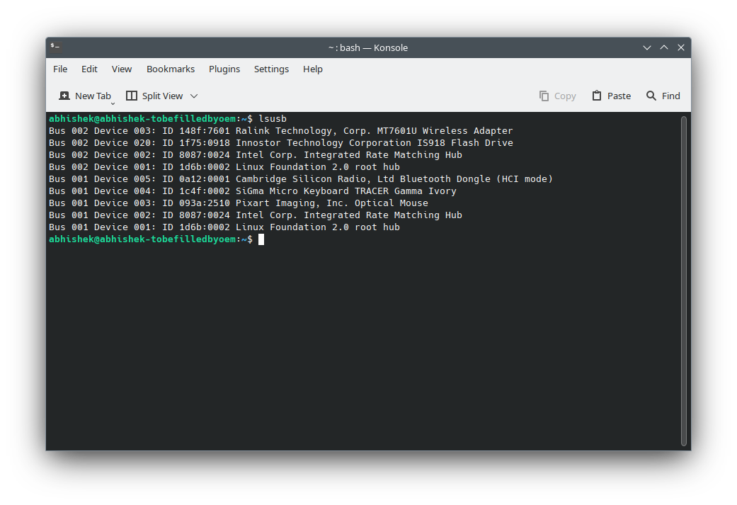

usb flash drive not showing
when i connect Kingston128 GB flash drive it not showing. i use  kde partition manager  but not showing my flash drive. but when i use cmd "lsusb" show this. how to solved this please help
#2 2025-01-05 13:29
Posts: 1,387
Re: usb flash drive not showing
Plug in the flash drive then run
sudo inxi -Fxxxmprz
and copy/paste the results back here please.

#4 2025-01-06 08:09
Posts: 1,387
OK.
Do any other flash drives work?
If they do then it is most likely the way the Kingston is formatted.
Is it new or has it worked OK in the past.
Has it been used on a Windows machine?
