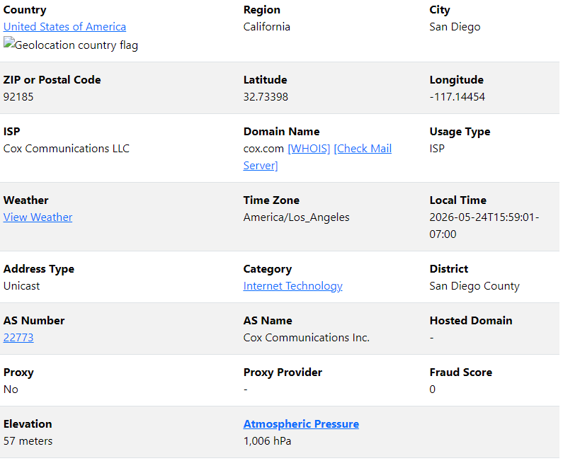

I ran the desktop profiler again, and I got the same 104 issue, even using the alternative DNS services.
My geolocation is in the attached PNG.
