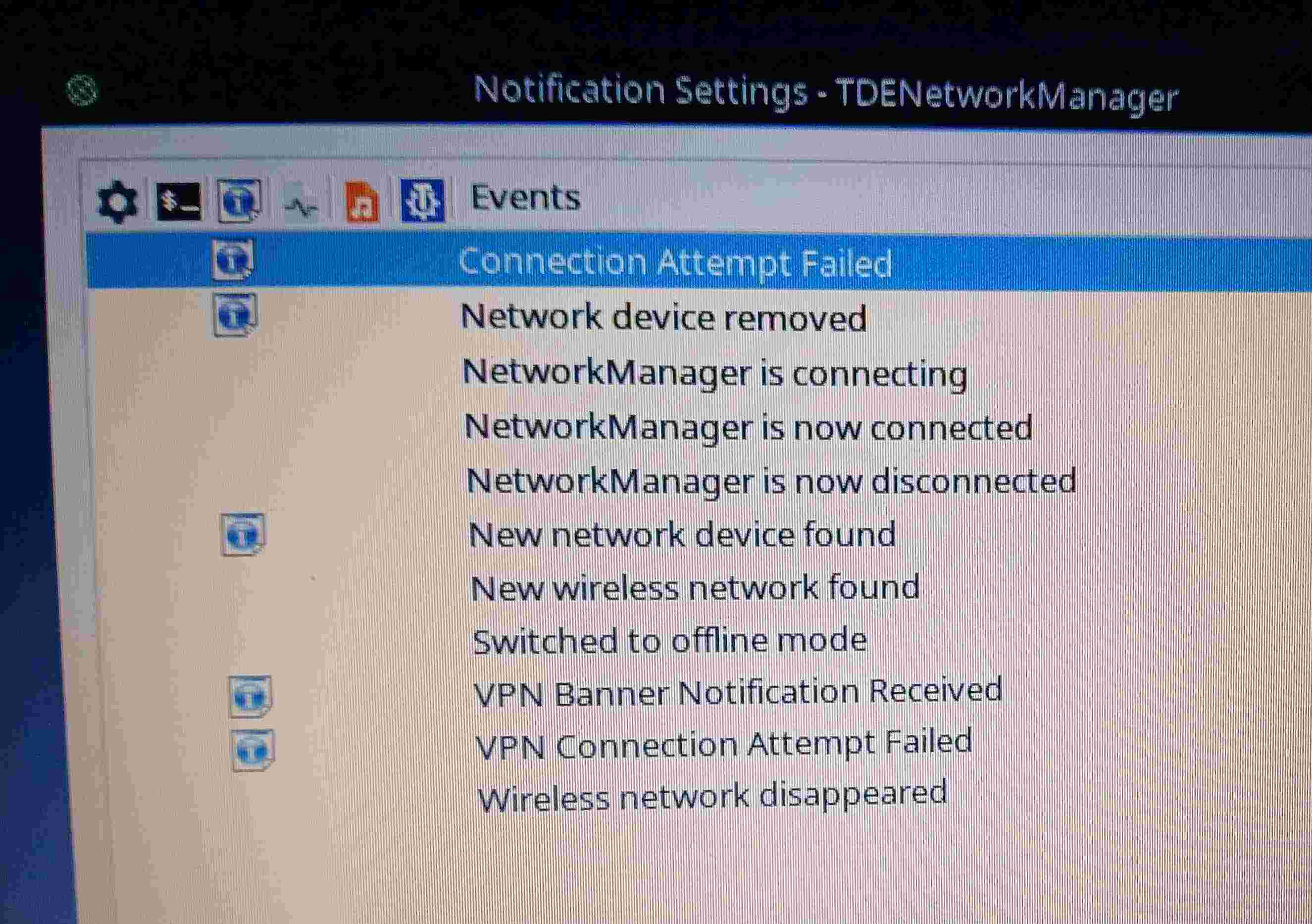

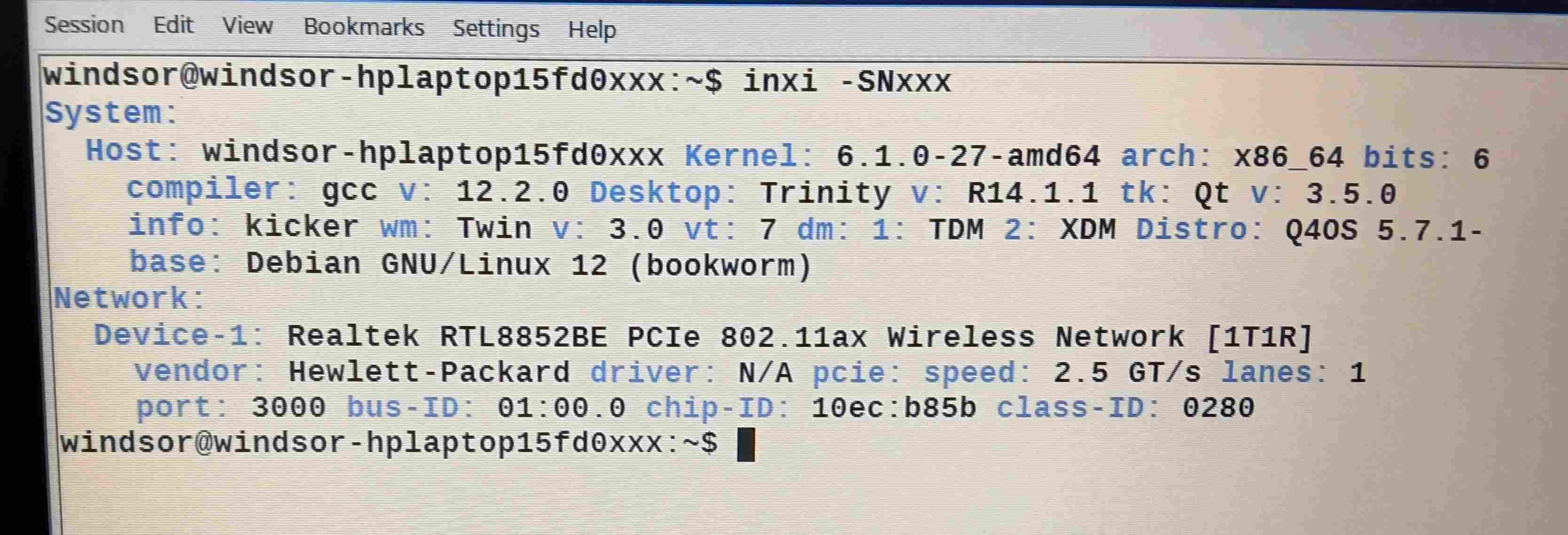

I have installed Q4OS Trinity on HP laptop. Most things seem to be OK but the Connection Management is having serious trouble. I cannot get any internet, no WiFi. See my attachment. Apparently net card is not working or lacks driver (It works fine on Win 11 which is also on this pc.) I will also send another attachment shortly that shows the Network Manager notification and how the connection attempt failed.

Network Manager notification of connection failure.

Re: NO WiFi connection link selectable from installation framework.
Did you install vpn? If so, try close vpn-reboot-connect-run vpn.
I use proton and at first it will kill connection and won't run, reboot should solve

Posts: 6,115
@win82
Please follow https://www.q4os.org/forum/viewtopic.php?id=4698 and post back the result.
