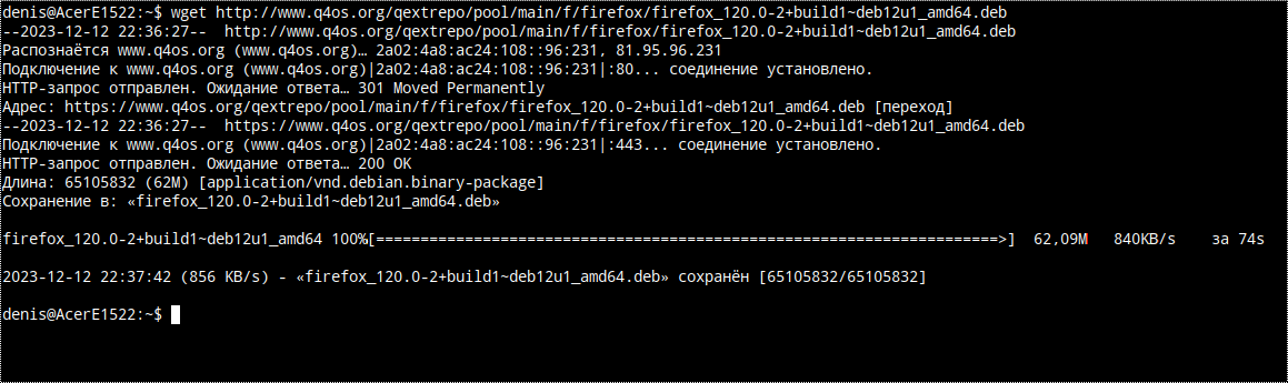

#3 2023-12-12 21:46
Posts: 637
Re: [Solved] Very slow download speed from q4os repository
Today, I have tried again using your command to download from q4os.org. The download speed was 840 KB/s, which was a bit faster but still very slow (attachment). Also, I have tried to download at night, when Internet traffic is less intensive and servers are not so loaded as in daytime. So, I suppose, that it is not a temporary glitch.

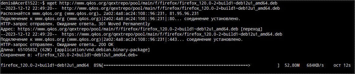

#4 2023-12-12 21:52
Posts: 637
Tried again, and download speed became even slower sad
My Internet speed is 48Mbps. (attachment).

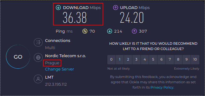

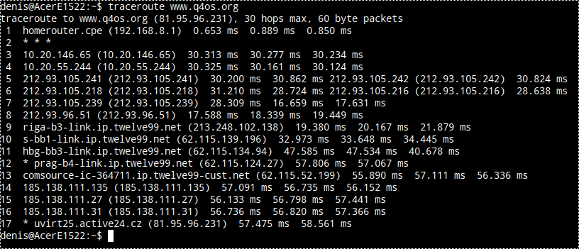

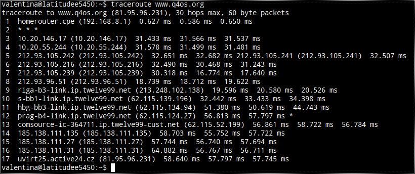

#10 2023-12-15 11:10
Posts: 637
hchiper wrote:
Your speed test involves another server (DEAC in Riga? which is nearby where you live) and a different (shorter) route, involving other intermediate machines, if any.

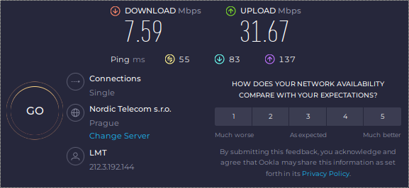

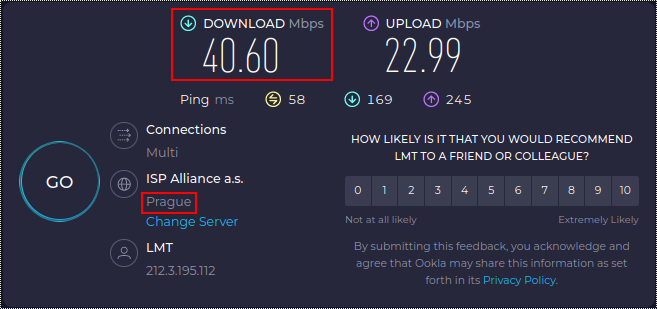

I have tested my internet speed, using two servers, located in Prague. Inernet speed is OK. See attachments.
hchiper wrote:
Between Q4OS' server and your computer, the wire is long and there are many intermediate machines, whose one might be responsible.
Traceroute is in attachment.

#11 2023-12-15 18:35
Posts: 613
OK, the delays look like good. I have nearly the same.
Now what about your download speed from q4os.com with this situation? Better? Still slow?

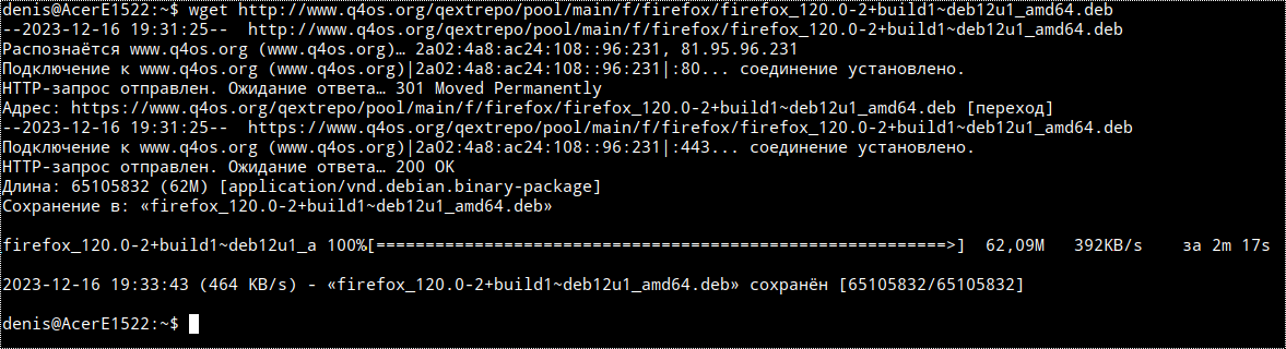

#12 2023-12-16 14:32
Posts: 637

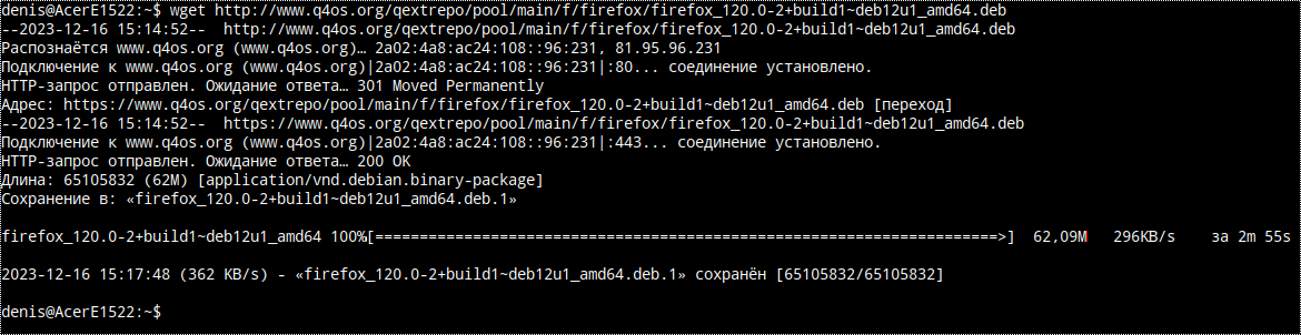

Very bad! Still only about 300 KB/s sad See attachments.
But the traceroute is good.
I am sure, that the problem is in q4os.org server, and not in my Internet, because downloading from another servers is still very fast. Only q4os.org server has so slow download speeds. If I would be confident, that the problem is in my Internet connection, I would not create this topic.
