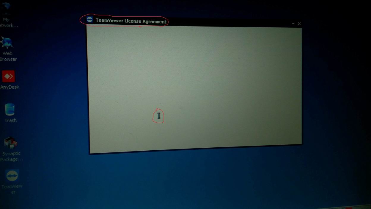

Teamviewer doesn't work (strange empty windows...)
Hi everyone,
I installed "q4os-3.14-i386-instcd.r2.iso"  + Teamviewer using "setup_q4os-teamviewer_2.2-a1_all.esh"  from Sourceforge.
Everything went well, the installation seems to be OK.
When I started the Teamviewer, appears an empty white window, with "Teamviever License agreement" title.
I was angry and I started to click a lot on the white window in different places. Clicking somewhere on the upper right quarter, the window moved to Tray. Probably I found a hidden "YES" button...
On right click on the tray icon, appears the little tray menu but clicking on any option I see just a white window.
For short: the Teamviewer seems to working but I cannot see the content of any window belongs to Teamviewer.
PS. : the 3.12 version made the same error...

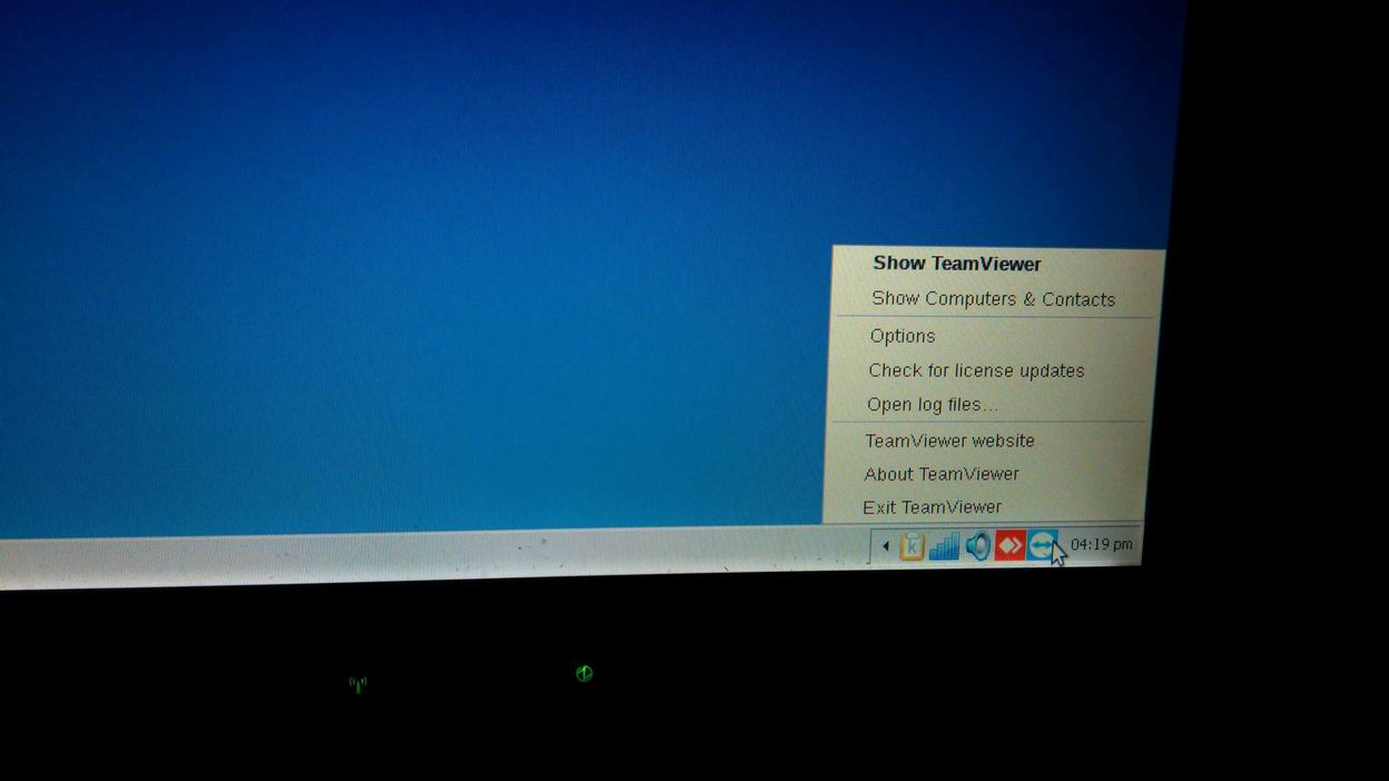

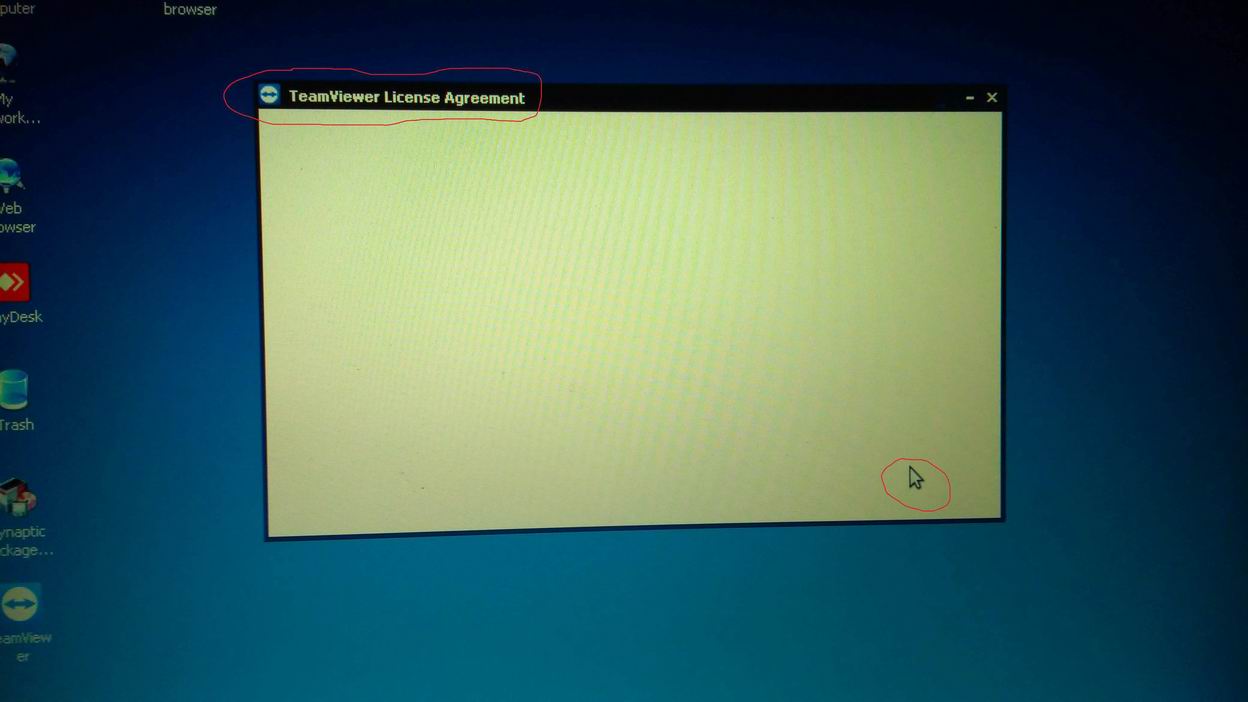

I attached some images...

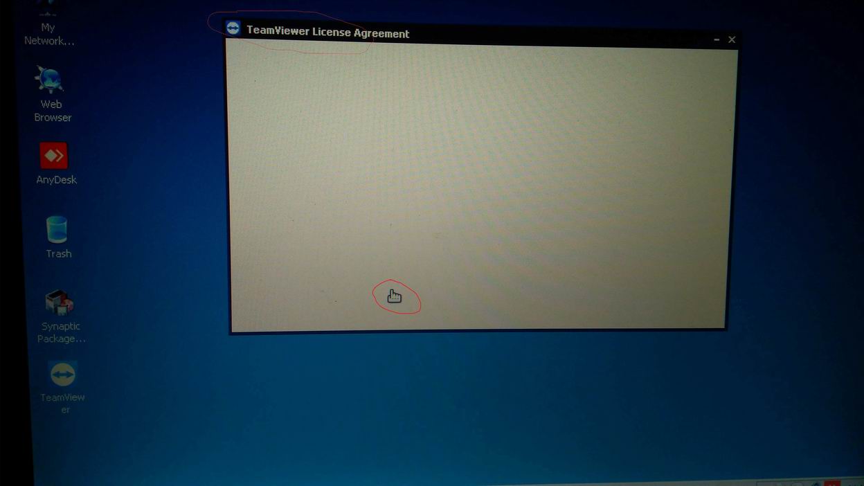

images part II
I forgot: I made a fresh Q4OS installation , without any leftover packages....

Probably this is a Debian Buster problem. I  found this error also in AntiX 19.3 . I downgraded my OS to Q4OS 2.7 but in this Debian Stretch based OS everything works well !
