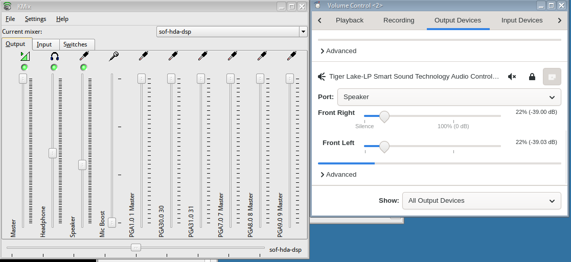

When I play something on VLC (or Youtube videos in web browsers etc), the audio output is either from my laptop speakers AND headphones (left side only), or nothing at all.  VLC isn't the problem and my headphones work fine on other OSs.
I have installed kmix, PulseAudio and pavucontrol.
In my screenshot, "Headphone" and "Speaker" are unmuted in kmix. In Volume Control, everything else (DisplayPort 1, 2, 3) is muted except for "Port: Speaker". If I only mute "Speaker" in kmix, there is no output from my headphones.  What is happening here?

Then in Volume Control, on the Output Devices tab, change Port: from
Speaker to Headphones. That dropdown is what selects the output.
One more thing: please do not touch the Speaker and Headphone switches in
KMix. KMix talks to the sound card directly, while PipeWire uses those same
switches to mute the speakers when you plug headphones in. Setting them by
hand overrides that - which is why you get both outputs at once, and why
muting Speaker also silences the headphones. Use Volume Control instead.

Next, in Volume Control, the only "Port:" option is "Speaker." There is no "Headphones" to choose.

Ok thanks. I haven't touched the speaker/headphones settings since your first reply.
Here is the output from "cat /proc/asound/card0/codec#0 | grep -i -A5 -B2 jack":
  Pincap 0x00003724: IN Detect
    Vref caps: HIZ 50 GRD 80 100
  Pin Default 0x03a11040: [Jack] Mic at Ext Left
    Conn = 1/8, Color = Black
    DefAssociation = 0x4, Sequence = 0x0
  Pin-ctls: 0x24: IN VREF_80
  Unsolicited: tag=02, enabled=1
  Power states:  D0 D1 D2 D3 EPSS
  Pincap 0x0001001c: OUT HP EAPD Detect
  EAPD 0x2: EAPD
  Pin Default 0x03211020: [Jack] HP Out at Ext Left
    DefAssociation = 0x2, Sequence = 0x0
  Pin-ctls: 0xc0: OUT HP
  Unsolicited: tag=01, enabled=1
output from "wpctl inspect 48":

    api.dbus.ReserveDevice1 = "Audio0"
    api.dbus.ReserveDevice1.Priority = "-20"
  * client.id = "47"
  * device.api = "alsa"
    device.bus = "pci"
    device.bus-path = "pci-0000:00:1f.3-platform-skl_hda_dsp_generic"
  * device.description = "Tiger Lake-LP Smart Sound Technology Audio Controller"
    device.enum.api = "udev"
    device.icon-name = "audio-card-analog-pci"
  * device.name = "alsa_card.pci-0000_00_1f.3-platform-skl_hda_dsp_generic"
  * device.nick = "sof-hda-dsp"
    device.plugged.usec = "8187091"
    device.product.id = "0xa0c8"
    device.product.name = "Tiger Lake-LP Smart Sound Technology Audio Controller"
    device.string = "0"
    device.subsystem = "sound"
    device.sysfs.path = "/devices/pci0000:00/0000:00:1f.3/skl_hda_dsp_generic/sound/card0"
    device.vendor.id = "0x8086"
    device.vendor.name = "Intel Corporation"
  * factory.id = "15"
  * media.class = "Audio/Device"
    object.path = "alsa:acp:sofhdadsp"
  * object.serial = "48"
    spa.object.id = "2"

#9 2026-08-24 16:25
green-moomin
Registered: 2026-08-05
Posts: 18
Re: Audio problems with laptop speakers and headphones
Thank you for the detailed answer. I followed the steps and the audio is working properly now.
My laptop model is "HP EliteBook 830 G8 Notebook PC."
The command "amixer -c0 contents | grep -i -A2 jack" with headphones plugged in gives output:
numid=14,iface=CARD,name='HDMI/DP,pcm=3 Jack'
  ; type=BOOLEAN,access=r-------,values=1
  : values=off
numid=20,iface=CARD,name='HDMI/DP,pcm=4 Jack'
  : values=off
numid=26,iface=CARD,name='HDMI/DP,pcm=5 Jack'
  : values=off
numid=12,iface=CARD,name='Headphone Jack'
  : values=on
numid=11,iface=CARD,name='Mic Jack'
  : values=off
numid=13,iface=CARD,name='Speaker Phantom Jack'
  : values=on
"amixer -c0 contents | grep -i -A2 jack" headphones not plugged in:
  : values=off
  : values=off
  : values=off
  : values=off
  : values=off
  : values=on
