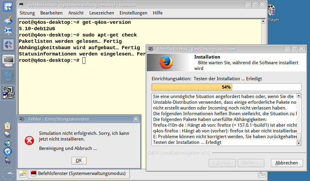

#9 2026-10-08 12:42
HerrAbisZ
From: noch Wien
Registered: 2023-10-26
Posts: 38
Re: Unable to install Firefox in 32bit Trinity 2026 Version
The text goes something like this: “Firefox cannot be installed right now—cancel and clean up.” I'll take a screenshot when I have it again.
I'm currently trying to set up a dual-boot system with q4OS on a netbook running Batocero 5.25, but I keep failing because I don't understand the commands in the terminal yet.
Acer Aspire D150
BITTE helft einander! Mehr auf meinem Blog http://herrabisz.wordpress.com/ http://www.youtube.com/user/HerrAbisZ2 + 3
#10 2026-10-08 12:47
Posts: 6,493
Well, the screenshot would be helpful, or the exact message wording at least.
Added later 25 min 17 s:
Well, we are now able to reproduce the issue. We will investigate and post back.
#11 2026-10-08 13:21
HerrAbisZ
From: noch Wien
Posts: 38
patxi-p wrote:
Es beginnt zu installieren, bleibt aber bei den 52% mit der folgenden Nachricht: (übersetzt von Spanisch): "Die Simulation wurde nicht korrekt gemacht. Sorry, die Installation kann nicht fortgesetzt werden... Reinigung und Abbruch"
LIke this
#12 2026-10-08 13:22
Posts: 6,493
Well, Mozilla has stopped releasing FF for i386 architecture. We can only recommend you to install Debian's Firefox ESR from repositories:
$ sudo apt install firefox-esr
In anyway we will fix the installer, thanks for the report.

#14 2026-10-08 15:16
Posts: 6,493
Installer is fixed now and installs Firefox-Esr.
