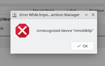

error in gparted
I have a laptop with a tf card slot. I have a 128gb card formatted as exfat I use with windows and q4os. When attempting to format, I get an error (screen shot is attached). This error does not occur with Mint or Windows, only Q4OS. It is nothing serious, but puts me off from recommending Q4OS to others. Thoughts? Solutions?
Thanks.
#2 2026-03-04 14:56
Posts: 6,093
Re: error in gparted
Try to install additional packages:
$ sudo apt install exfat-fuse exfatprogs
and post back the result

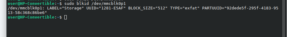

#8 2026-03-04 16:39
Digidoc
Registered: 2025-03-15
Posts: 36
I have 1 screen capture attached. I do not know how to do all 3 at once.
I went back and started over.
Gparted.
Device - Create new partition table:
GPT and a new exfat partition leaves 1mb unallocated.
MSDOS and a single exfat uses the entire drive.
Both options now work and the format completes without getting errors.
Did your earlier commands fix the problem?
EDIT:
The actual device was not mmcblk0 but actually mmcblk0p1 The error was something to do with Gparted!
BTW, this laptop has a touch screen. The forum text was so small I was struggling to see and edit my posts. I found (by accident) I could pinch and zoom the screen and now it works -great-. I also found (online) the details of capturing screen shots so errors can be viewed (and sometimes reported).
Thank you. Problem now solved!
