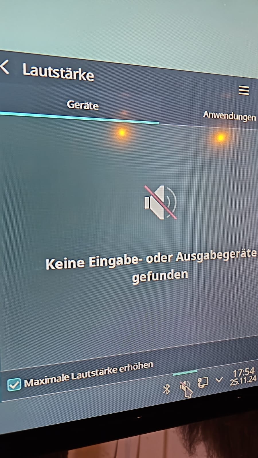

2. Sound didn't work: After clicking on the sound symbol on bottom right there was the following message - "No input or output devices found."
After the PC was running for some time the sound worked but after a restart it was gone again?

Ad2 What application does show the message ? A screenshot would be helpful.

Ad2: I can not attach a picture but it's shown after you click on the sound symbol on bottom right.
Ad3: That's not good...

Ad2 Please attach a screenshot here.

Ad2: Image attached.

Ad2: Please run in terminal:
$ sudo inxi -Aa
and post back the output
