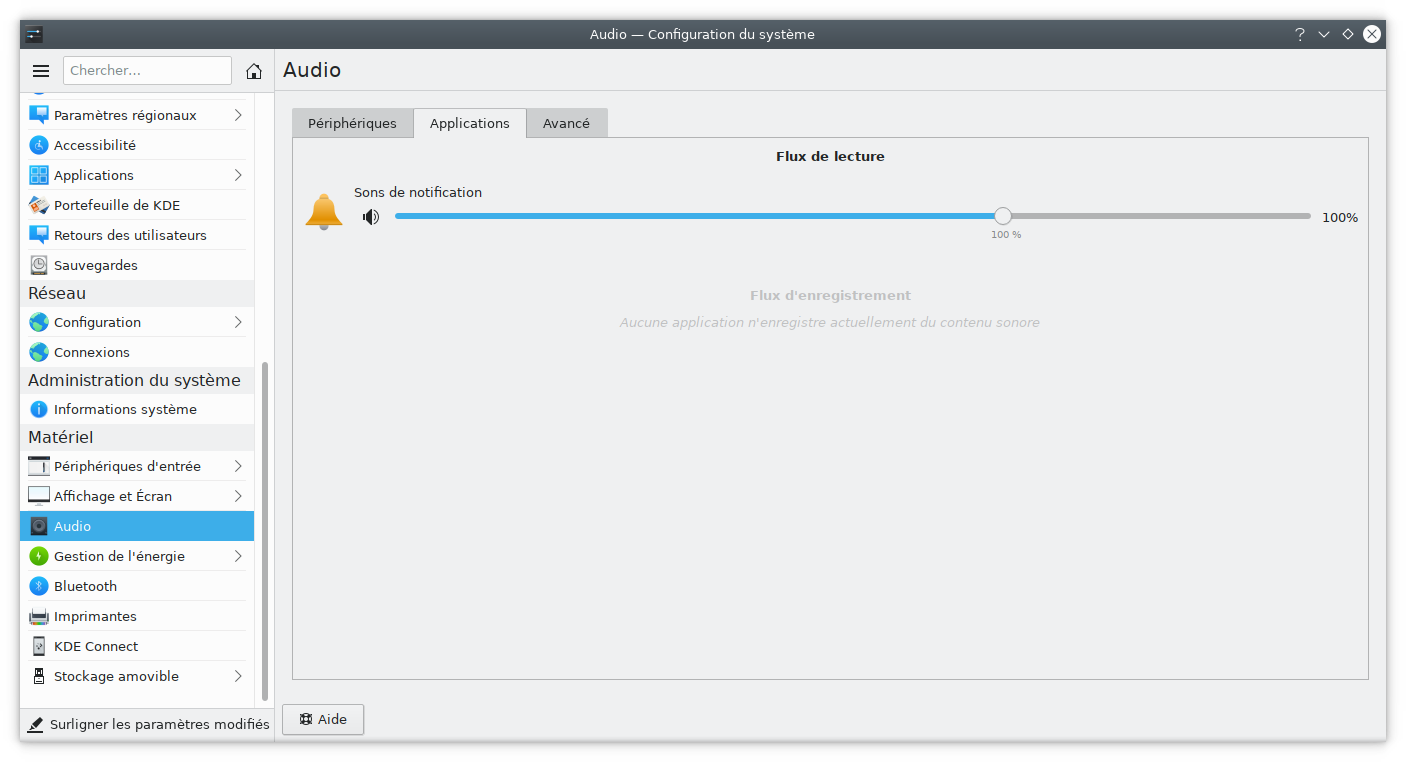

  1. Matériel / Audio: verify that audio is enabled and that the volume cursor is high enough

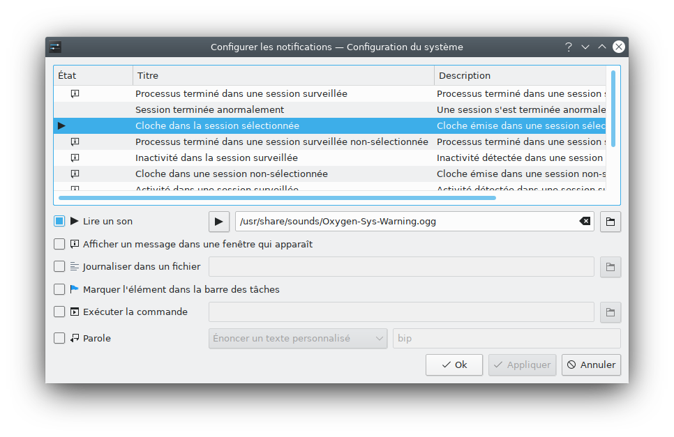

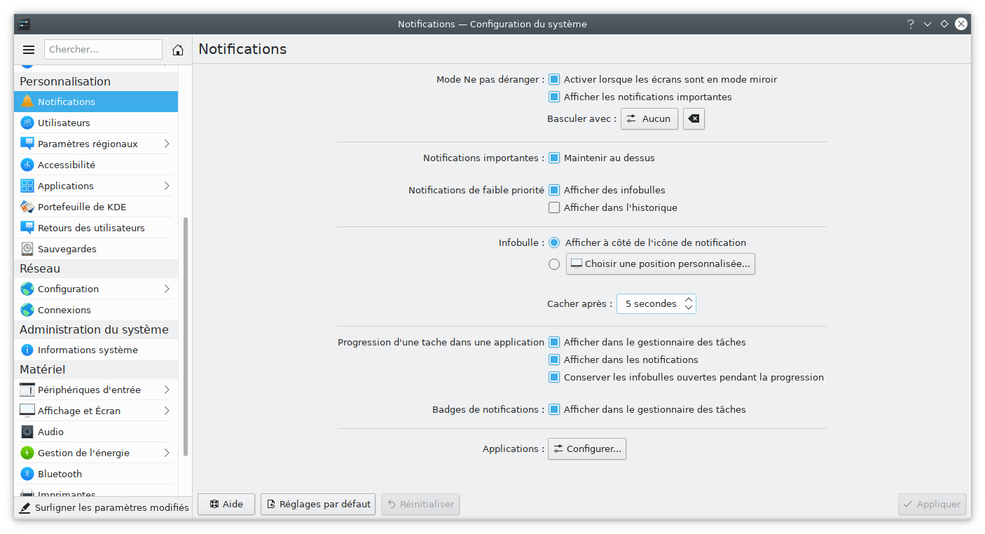

  2. Personnalisation / Notifications: click on "Configurer" at the bottom of the panel on the right
  3. in the list at the right: choose Applications / Konsole and clic on "Configurer les événements"
  4. in the new window: select "Cloche dans la session sélectionnée", activate the chackbox "Lire un son", choose a sound, then click the "OK" button

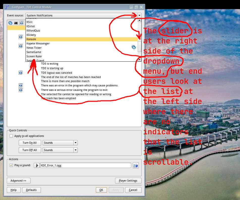

We guess, @martin_vahi do have "konsole" in the list, he only needs to scroll up in the listview as seen from the gif video.

We can see "Kopete Manager" item in the list. What item is just above that one ? It should be "Konsole", but it's not visible in the video.

Thank You for the kind and helpful replies. It turs out that indeed, it was a _USER_ERROR_AT_MY_PART_. From support point of view I consider this case closed. This forum thread provided me the advice that I was looking for. However, I do think that the user interface could be considerably improved to avoid  such end user errors in the future.
2024_07_10_Q4OS_Trinity_ControlPanel_SoundAndMultimedia_DropDown_menu_01
