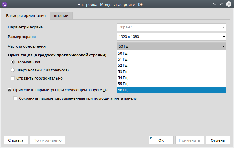

Wrong monitor refresh rate.
I have installed Q4OS 4.7 Gemini Trinity x64.
When I open settings:/Peripherals/ then Display, I always have wrong monitor refresh rates (attachment). No 60Hz, no 75Hz... Only 50, 51, 52, 53.... As result, I can not set up proper monitor refresh rate.

Yes, we can confirm this issue, it's not Q4OS specific, but Trinity bug.

What's the output of
xrandr
Launch konsole and run that. If the output shows the desired rate, you can set it with something like
xrandr --output HDMI-1 --mode 1920x1080 --rate 60
change the values to reflect your system's.
Bug was reported here: https://mirror.git.trinitydesktop.org/g … /issues/75
