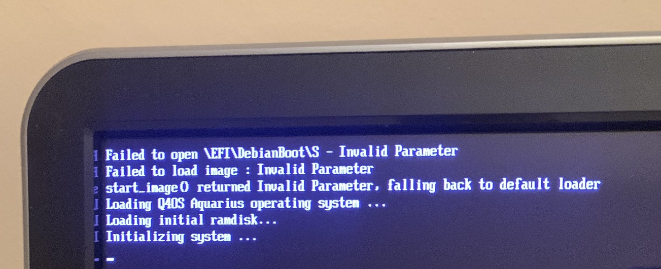

On the reinstall of Q4OS Windows after the first part of the install, when it gets to the bit that says "done your computer needs to reboot" when I reboot the first lines that come up say.
Failed to open #EFI#DebianBoot#S - Invalid Parameter
Failed to load image : Invalid Parameter
start_image() returned Invalid Parameter, falling back to default loader
Loading Q4OS Aquarius operating system ...
Loading initial ramdisk...
Initializing system ...
Then everything goes fine the install finishes and I set up the desk top environment, reboot and there is no Q4OS in the Boot Menu only Windows.
Looks as if the "Failed .... Invalid Parameter" stuff stops the Q4OS being registered but I can not fine any ref to what to do about it !

A bit more info is that at the very end of the install this is part of the messages that come up.
..... detect bootable binaries on them ...., and stuff happens to try and add a boot menu entry.
I assume that the earlier "Failed to load image" means there is no binary to find and hence no boot menu entry can be created!

#17 2025-11-25 16:09
Posts: 6,294
Re: Set up dual boot Win10 Q4OS
@digbyd11
It looks something is removing Q4OS boot entry from Bios. Maybe antivirus or some other protective software ? You could try fix Q4OS bootloader entry from Windows this way:
- Navigate to the folder where the fixefiboot.bat file resides. The path should be something like this: C:\Windows\linux64\Debian12_S001\winboot\EFI\ (You may need to adjust the drive letter if your Windows partition isn't C:, but it usually is).
- Locate the file named "fixefiboot.bat"
- Right-click the fixefiboot.bat file.
(Run as administrator)
- When finished, restart
Post back the result please

Sorry I do not understand my post is part of my ongoing issue which has not been solved.
Have now tried uninstalling again and installing to my E: drive instead.  That killed my computer as on reboot the system could not find the Windows install.  After about 10 reboots which kept failing I use ESC on boot up which got me the Grub screen.  Booting to the second limited boot to Q4OS from this Grub resulted in a full install and system set up of Q4OS with a reduced desk top set up.  Then able to install web browser and office with this all seeming to work fine. BUT. Then on reboot the boot menu comes up with the only option being Windows, no Q4OS option. So it seems I have a fully functioning Q4OS on my computer which can not be booted.  So the topic is still Set up duel boot Win 10 Q4OS because the install system does not correctly register in the boot menu.
I do not know where the "nifick" stuff is from which does seem to be a different topic.
It seems to us the OP issue has been resolved see @twosheds post https://www.q4os.org/forum/viewtopic.ph … 914#p32914 . For that reason we have asked you to create a new one. It will also make the discussion more clear.
nirick wrote:
The dual boot loads properly and gives me the choice between Q4OS and Windows. The problem is that after choosing Q4OS, the screen remains stuck on the underscore in the top left.
Do you have dual boot all right, the same way as @nirick ? If not, it's a different issue.
We guess it's quite different issue from the OP too, or can you find the Q4OS boot entry in BIOS the same way as OP ? Did you check BIOS ?
