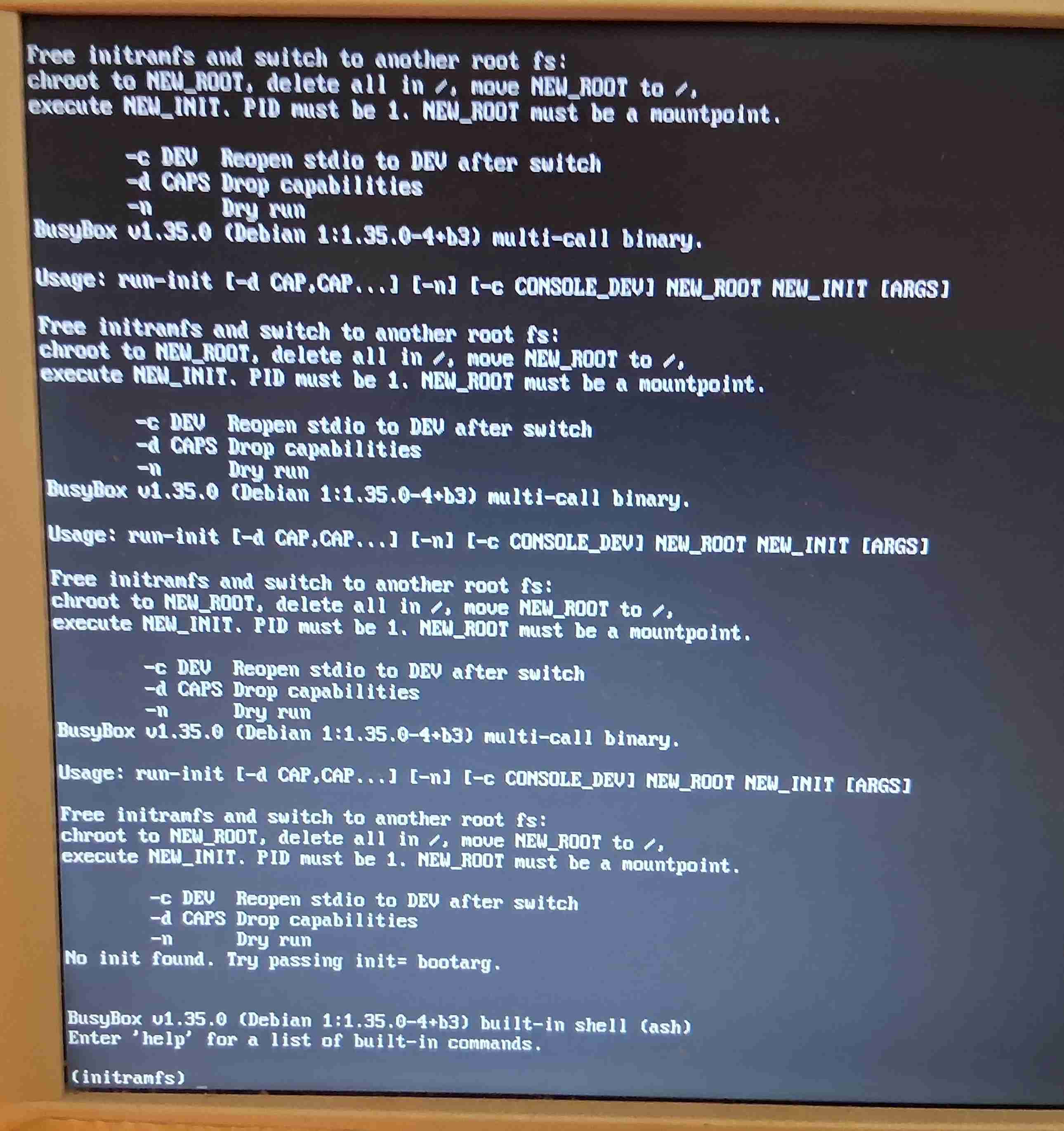

This pc will not longer boot from the windows boot manager. It by passes that and goes directly to Q4OS. Attached is a photo showing the Q4OS boot screen and where it stops. However, I could not get the photo to appear in the preview.

Well, how did you install Q4OS exactly ? Please specify Q4OS installation media, steps and settings throughout the install process, partitioning of your disk.
