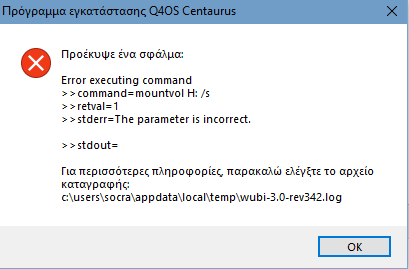

Thanks.
This is the error message:

#6 2021-04-20 13:09
Posts: 6,115
Re: Q4OS Windows Installer Error
This issue seems to be related to Windows 10 bug https://github.com/MicrosoftDocs/window … ssues/1776 . You can easily test that, run Windows command shell as administrator and issue command:
mountvol X: /s
and post the output here. The command should map the EFI partition as X: drive. It may be blocked by some antivirus or another security software too.

#8 2021-04-20 14:27
Posts: 6,115
Yes, the message "The parameter is incorrect." confirms a Windows bug as mentioned above and it's the cause of Q4OS installation fail. This command works on Windows 10 normally. You can try to switch some security software off to unblock mounting the EFI partition and check the command again. As the command passes correctly, Q4OS would install fine. Unfortunately, we are not able to reproduce the issue and so investigate it properly. We would appreciate, if you report more findings, if available.

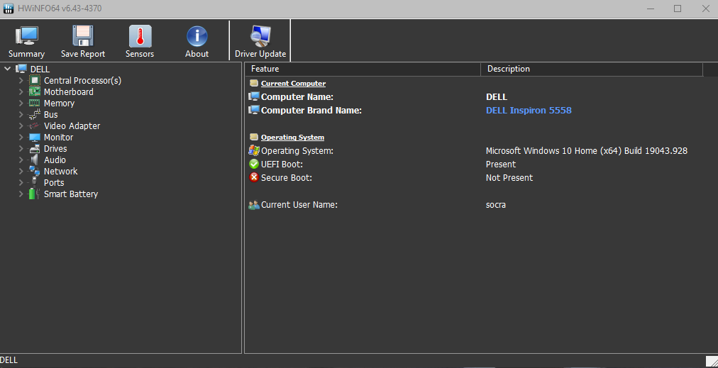

Does this mean it boots off UEFI?
#11 2021-04-20 18:35
Posts: 6,115
Not sure, use the following method to determine, if Windows booted in the UEFI or BIOS mode https://www.tenforums.com/tutorials/851 … -bios.html
Yes, it boots off UEFI.
