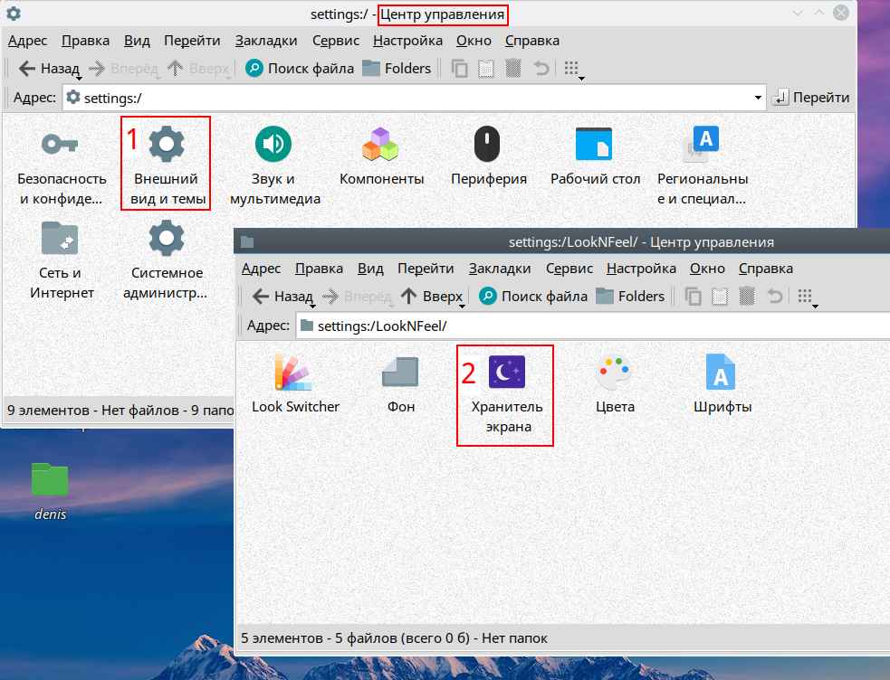

#2 2020-12-19 22:27
Posts: 637
Re: How to configure screen saver?
You can disable screen saver in START -> Settings -> Control center -> Look and feel (at least I think so, because I use Russian translated version) -> Screen saver (see attachment).
There is no such "intelligent recognition" as in Windows (at least I do not know about it). Remove tick from that option or configure activation period.

Please see attachment. You have selected the wrong menu. Look at icons.

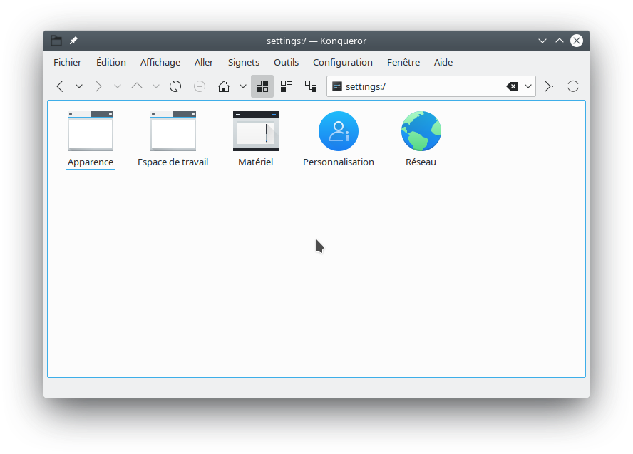

#6 2020-12-23 22:31
Posts: 519
Thanks for your reply, Rademes.
The only place where I can type
settings:/
is within Konqueror.
Unluckily, much less icons are displayed and there is nothing that looks like your icon 1.
Everything I see there is the same (with another layout) as what I get using Start > ... (as I described in my last post).
I also tried sudo konqueror, but that is not allowed.
