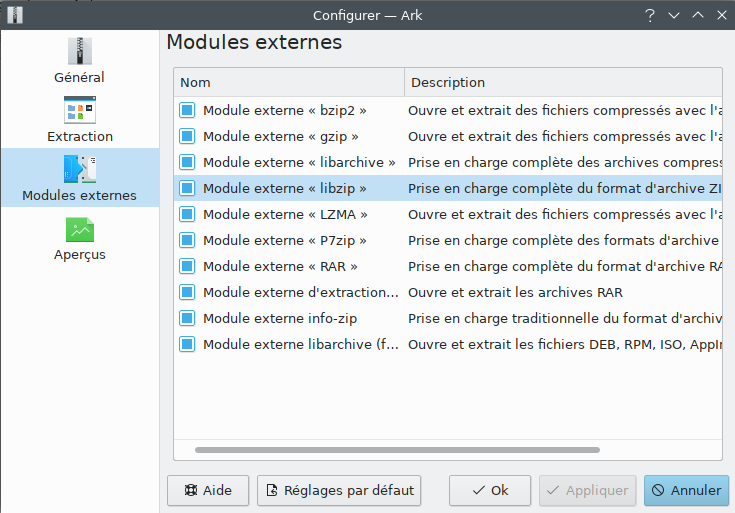

#4 2022-03-27 10:14
Posts: 519
Re: Error unzipping ZIP file in Q4OS Ark
rafaelramos wrote:
I didn't find any option in the Ark settings to disable libzip...
In the French version I'm using: from the main menu > Configuration > Configurer Ark... then choose external module (see screenshot attached).
rafaelramos wrote:
And I checked in Synaptic Package Manager and apparently the libzip library (libzip4 1.7.3-1) is not installed on the system...
You can also check in the console (or terminal) type
$ apt list libzip*
$ apt list p7zip*
If neither libzip nor p7zip is installed ("[installed]" written at the end of the line), then install at least one of them:
$ sudo apt install libzip4
$ sudo apt install p7zip

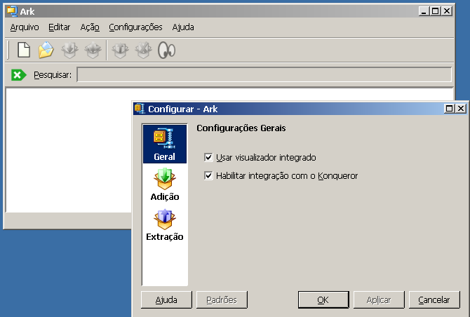

I attached a print of my Ark, where the option of "External Modules" does not appear as in yours...
#6 2022-03-27 11:12
Posts: 519
Your screenshot of Ark settings looks very different of mine and unluckily doesn't show the modules option (3rd choice in the left column in my screenshot).
What is your Ark version (mine is 20.12.2)?
Since p7zip is installed, you should first go to the modules display and check p7zip is present and enabled.
If it is present and disabled, then enable it and try again to unzip your file.
If it doesn't work, you might try to install libzip:
and check it is present in the list and enabled (it might require to close and restart Ark).

In ark menu:
Configuration > Configure Ark... > External modules
check P7zip
