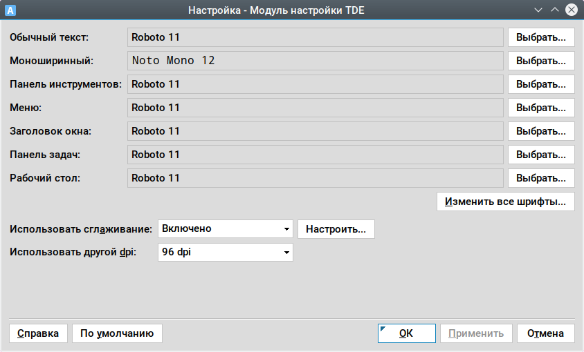

Currently, I have realized, that one of the best fonts for my monitor is Roboto. So, I have installed fonts-roboto metapackage, and have set Roboto font as default in Control Centre (attachment 1).

Firefox is a GTK app so you'll need to set that via GTK3 settings. gtk3-tqt-engine-trinity and gtk-qt-engine-trinity
SMPlayer is a QT5 interface so that will need qt5ct to set it - only don't bother if you are using TDE as you get a clash in qt with the environment.
You can set a custom font for:
GTK2 apps: $HOME/.gtkrc-q4os
GTK3 apps: $HOME/.configtde/gtk-3.0/settings_trinity.ini
QT5 apps: $HOME/.configtde/q4tde/q4tde.conf
GTK common apps: $HOME/.xsettingsd
