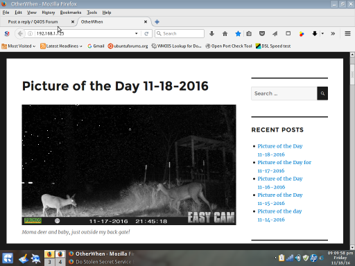

Ok, just in case someone else wants to try this. I followed the instructions at the link Bobby gave and it worked out fine.
I have an old Dell Latitude laptop and finally got a wireless pcmcia card for it. Installing LAMP was pretty straight forward with no problems.
I also installed Word Press and Webmin. Again, just followed the instructions with each and had no problems. This is for my local lan, and I use it for storing audio files as well as some snapshots taken from my game cameras. The link/computer does not work well for video's but can be used for that if I want. Just have to be patient and download the video to the tablet or other computer I'm using. I do have a free dns that allows family to access the laptop, if they want. But the upload makes videos almost unusable.
By using Webmin I can put the laptop in an out of the way place and access the system from my desktop.
Attached is a picture of my desktop computer accessing the WP webpage.
So, if anyone had been thinking of doing something similar then I would say to go for it!
