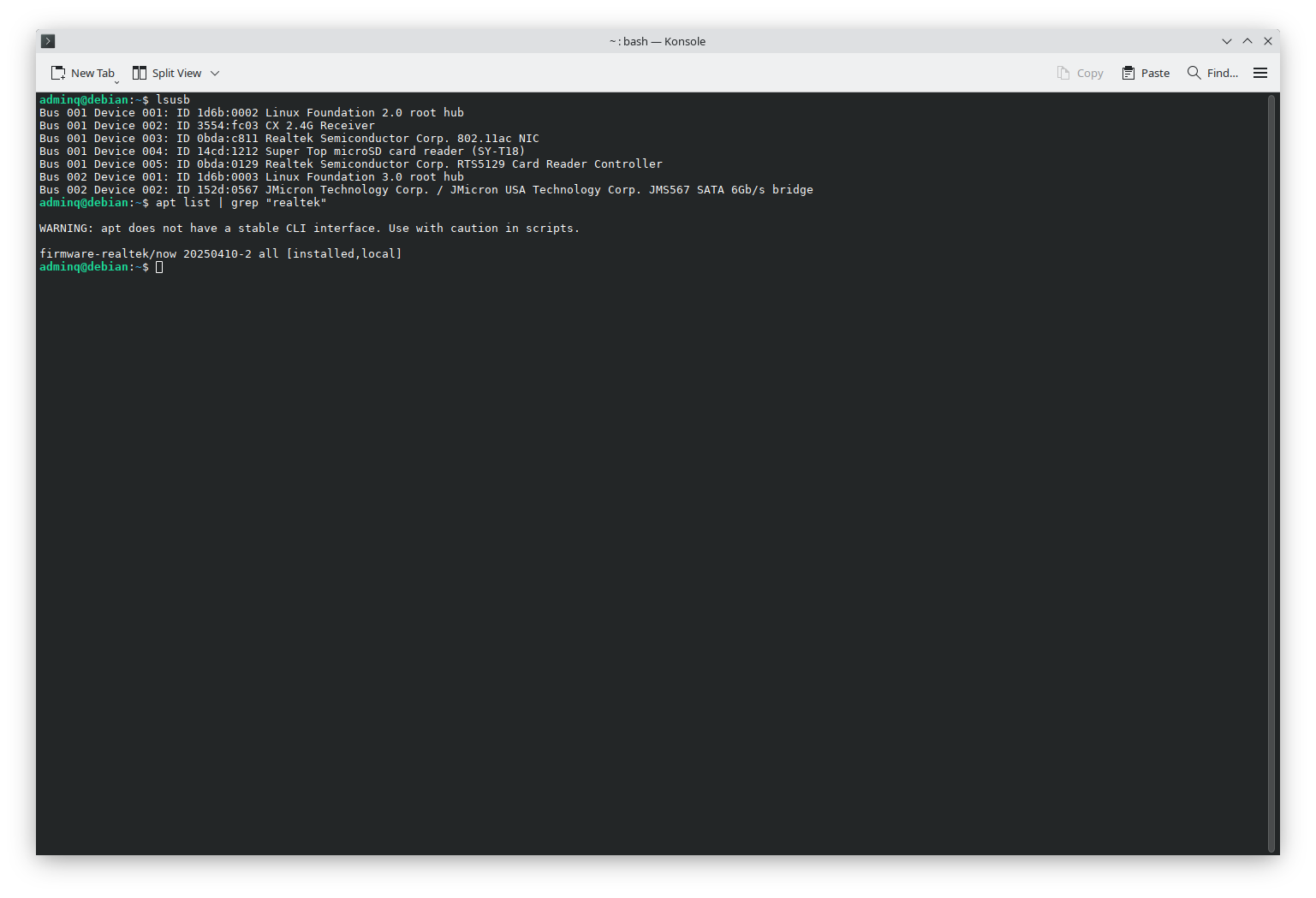

#8 2026-06-11 01:24
Digidoc
Registered: 2025-03-15
Posts: 78
Re: Can you download a driver and then move it?
I used the command:
apt list | grep "realtek"
It reports [installed, local]
Still no connections. What now please?
I am back to running live and have not re-installed Q4OS. My machine is a Dell Vostro 420; Core2Duo @3Ghz; 4gb memory, 1tb HDD.
I would like to download using Q4OS (or Windows) and then take the downloaded drivers to the Dell to install them there.
2 screen shots are attached. I am running live on my desktop. By using the ethernet connection, I was able to:
sudo apt update
sudo apt install build-essential git dkms bc
git clone https://github.com/brektrou/rtl8821CU.git
by changing to the folder rtl8821CU.git and ls, I can see the downloaded files. I can copy the folder to USB to take back to my Dell Vostro machine. Now, I am unsure what steps to take next.
Thanks.

#9 2026-06-11 07:11
Posts: 821
I can't say more than the detailed instructions available on that website.
But given that your hardware is not recent, I believe that you don't need more than the installed `firmware-realtek` package.
What are the output of these commands?
- $ inxi -Nxxx
- $ sudo rfkill

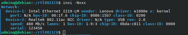

#10 2026-06-11 10:27
Digidoc
Posts: 78
Attached is a screenshot from your command: [inxi -Nxxx]
Your second command does not do anything.
PLEASE: I have mild dementia which seems to be getting worse. I ask your understanding as I struggle with life.
Allow me to recap my problem.
A)) I have a USB wi-fi not supported by any of 5 Linux distros.
B)) This is identified as: Realtek 0bda:c811
C)) I think I have the needed driver downloaded to: adminq@debian:~/rtl8821CU$
D)) This folder contains 19 files.
E)) Currently running live on a different computer where the ethernet is working.
F)) Running: [sudo ./dkms-install.sh] I get the error: Error! DKMS tree already contains: rtl8821CU/5.4.1 You cannot add the same module/version combo more than once.
G)) Also the error: Error! Your kernel headers for kernel 6.12.88+deb13-amd64 cannot be found at /lib/modules/6.12.88+deb13-amd64/build or /lib/modules/6.12.88+deb13-amd64/source.
Please install the linux-headers-6.12.88+deb13-amd64 package or use the --kernelsourcedir option to tell DKMS where it's located.
Finished running dkms install steps.
I am at an impasse, I do not know how to continue. ✦ Mike ✦

Posts: 821
These results seem strange:
1. from inxi output, no driver is associated to your WiFi-USB, although firmware-realtek is installed;
2. rfkill doesn't detect it.
I don't know whether your failed command with dkms has interfered.
If possible, undo what you have done with dkms (I don't know how, I never used dkms, it is not even installed on my system), try to reinstall firmware-realtek, reboot (maybe unnecessary) and see if the two commands above give normal results.
