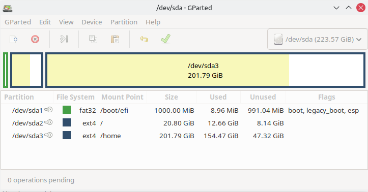

#2 2026-01-27 08:24
Posts: 1,608
Re: grub problem on Q4OS plamas
The error message says that there is not enough space for the boot entry.
You have a gpt partitopn table.
So, you need a partition for boot which should be 1Gb - it can be less but if you try different distros that will be OK for most.
Then you need your root partiton for the OS
Finally a third partition for your data.
