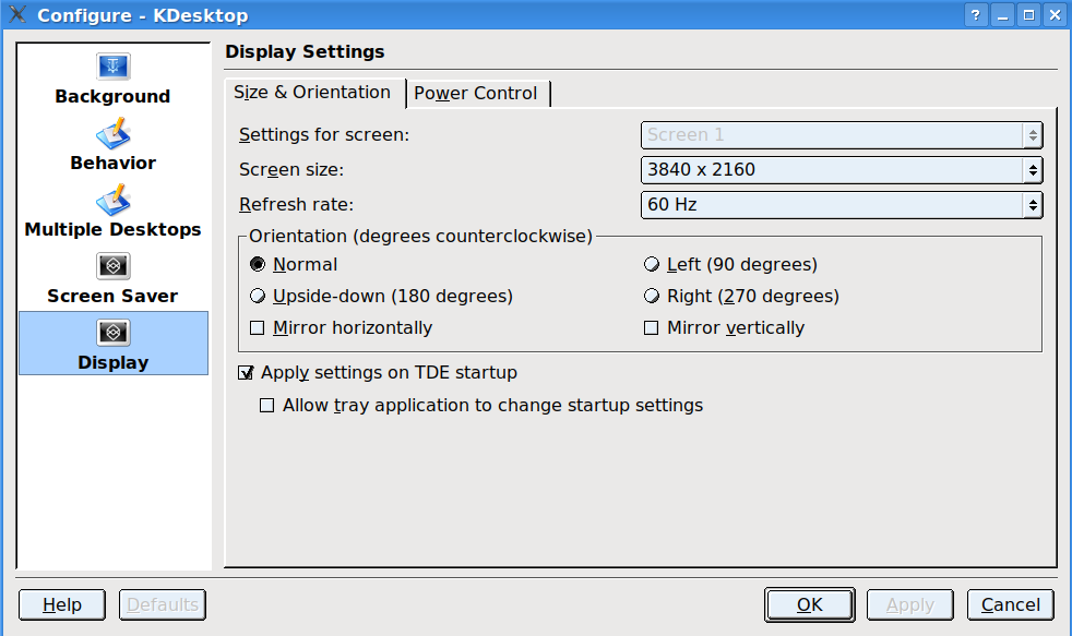

update 3: Finally I was able to install nvidia drivers without issues! I just had to disable secure boot and woah! It works fine!
I just want to know how I can pair two monitors (a digital drawing tablet) and this works fine with trinity? I want to make some modifications but in Kdesktop looks gray
