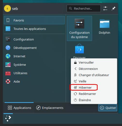

Just tried to install q4os+plasma DE with a swap partition, never did it before, (with default install parameters) in virtualbox and hibernation seems to work "out of the box" (???) ...  And it's ok too with q4os trinity.
So:
- It seems I was wrong about the swap partition that can't be used for kernel swapping AND hibernation function, it seems it works (but I have serious doubts about the default size which is 1Gb, doesn't seem enough if we have a lot of memory pages to 'hibernate' and if it's already used by kernel swapping - that's why I prefer a swap file instead of a partition by the way, it's easier to resize - )
Maybe I was right about the swap on a file, but /swap on a partition seems to be ok to 'share' kernel swapping & hibernation.

#15 2024-03-14 13:12
dlrider
Registered: 2024-02-26
Posts: 19
Re: Hibernation?
seb3773 wrote:
dlrider wrote:
making sure I selected the install option hibernation.
Maybe that's the problem, I always install Q4OS without swap partition (because a swap file is more versatile - and it's size can be rather easily changed, I don't see the benefits of using a swap partiton)  and apply my script after installation done. I don't know how it is set when you select swap partition at installation...
Some questions to help to resolve the problem:
what is the output of this command on your system :  sudo swapon -s
and this one : cat /etc/fstab
Interesting.  I'll try install without hibernation with another install process.
$ sudo swapon -s
[sudo] password for dlrider:
Filename                                Type            Size            Used            Priority
/dev/zram0                              partition       4034452         138868          100
/swap                                   file            8082428         0               -2
cat /etc/fstab:
# <file system>             <mount point>  <type>  <options>  <dump>  <pass>
UUID=7F46-B7B1                            /boot/efi      vfat    defaults,noatime 0 2
UUID=dcdaf202-8a97-402a-8a9a-79170eb1c0d3 /              ext4    defaults,noatime,discard 0 1
UUID=3b49bc01-622b-428f-b92f-fc5d896ba8be swap           swap    defaults,noatime,discard 0 0
tmpfs                                     /tmp           tmpfs   defaults,noatime,mode=1777 0 0
/swap                                     none           swap    sw,pri=0 0 0

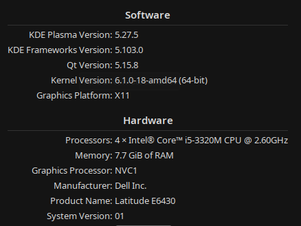

#20 2024-03-15 00:42
dlrider
Posts: 19
Re: Hibernation?
dlrider@q4os-latitude-e6430:~$ sudo systemctl hibernate
Call to Hibernate failed: Sleep verb "hibernate" not supported
Hardware info attached.
#21 2024-03-15 09:23
Posts: 147
Re: Hibernation?
can you try to disable secure boot in BIOS/EFI ? This maybe in relation.
