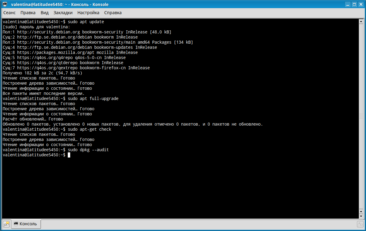

If in doubt and want to do some checking, run in terminal:
$ sudo apt update
$ sudo apt full-upgrade
$ sudo apt-get check
$ sudo dpkg --audit
#3 2024-01-24 20:00
Posts: 637
Re: Warnings after Aquarius update
Thank you Q4OS Team!
I have checked, using your commands, but did not get any errors. (attachment)
