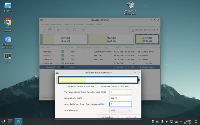

I can't resize the q4OS partition even with gparted

#23 2023-11-26 15:58
HerrAbisZ
Registered: 2023-10-26
Posts: 28
Re: Q4OS 5.3 Aquarius no installation of programs from the software center
Here
I am now doing two new installations and partitioning first with GParted - also the SWAP partition. And then 5.3 x64 tde.r1
BITTE helft einander! Mehr auf meinem Blog http://herrabisz.wordpress.com/ http://www.youtube.com/user/HerrAbisZ2 + 3
#24 2023-11-26 17:46
HerrAbisZ
Posts: 28
I have now reinstalled twice. Once I reinstalled the partitions with SWAP - then the file system got corrupted again. After the repair I saw that I had 5 primary partitions under MBR ??. Then I realized why the file system was broken for the time being, because 5 primary partitions were not supposed to work. But then it did.
Then I extended windows and let the KDE partition program set up the partition on the side. No file system was broken (only 4 primary partitions), but the GUI installation still didn't work. New install after win7 then ran a CHKDSK, so the KDE partition program doesn't work properly.
Now I am installing Q4OS 5.3 Trinity. Let's see what comes out of it
