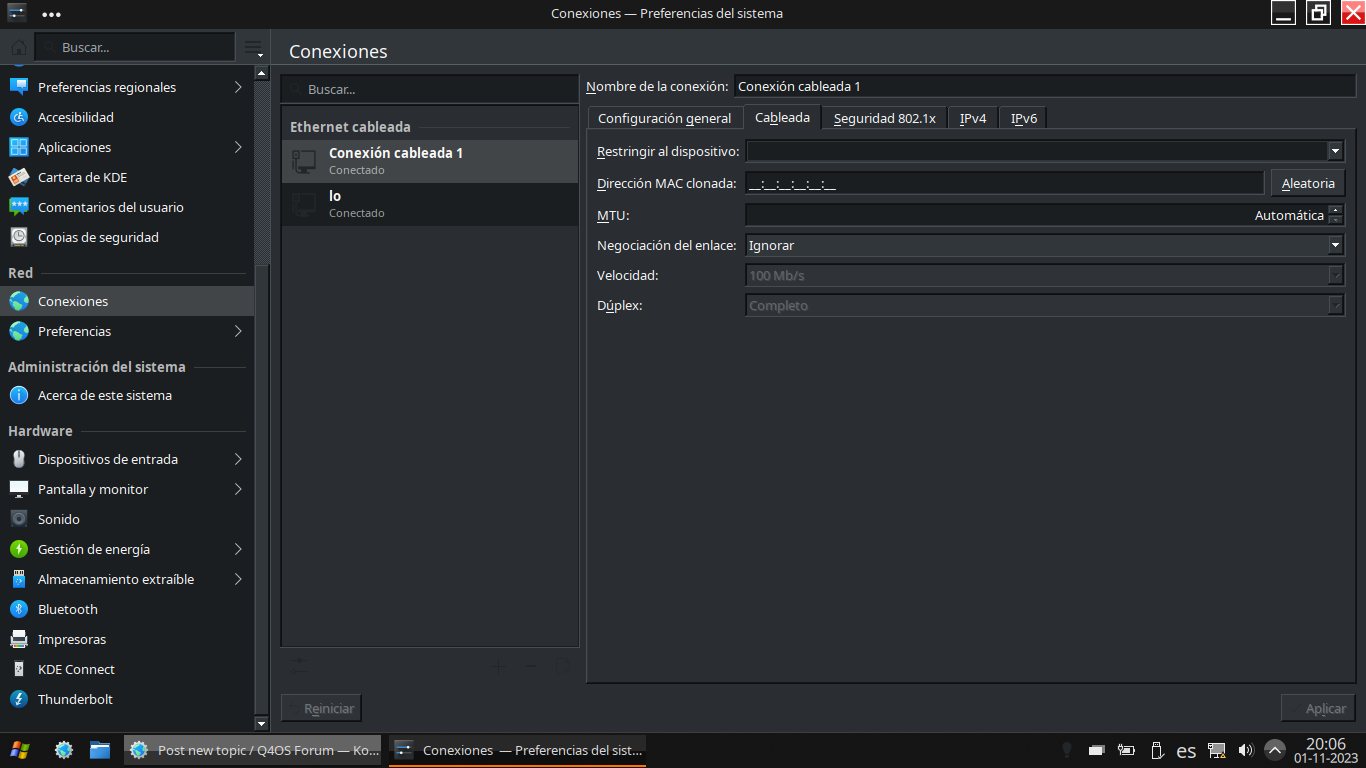

I just installed Q4OS Plasma in hp ProBook4310s in fifth laptop, and it doesn't have wifi, the system says error. But I accidentally deleted the wifi section looking for a way to connect to wifi. I can only connect to the internet via cable.
1. How to get the wifi module back in "System Preferences".
2. How I have wifi.
Help me please, thank you in advance.
PD: Attached image.

There are 3-4 buttons above the "Reinitiar" button, but they are barely visible with your dark theme. Among them there is a "+" button to add a connexion; there you can choose to add a WiFi connexion.
I also notice there is an exclamation mark on the network icon in the tray...
Is your WiFi enabled? What is the output of
$ sudo rfkill

It seems your WiFi is set off ("blocked') by a hardware ("HARD") switch. Is there a (small) switch somewhere on (the side of) your laptop? Or maybe disabled in the BIOS?
