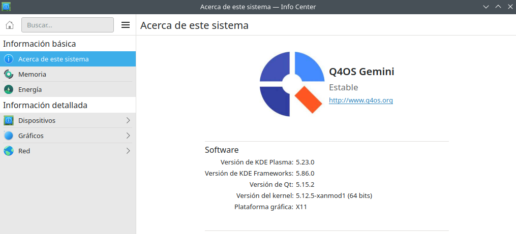

I did a timeshift backup, but it looks to me from this screenshot that I have Plasma 5.20 https://i.imgur.com/fTGpdYt.png
I must have missed something? Or, can I proceed to install the updates from the file manager?

Yes, that screenshot confirms Plasma version's still 5.20. To make the "code lines", you use bbcode, like this:

#22 2021-10-16 14:08
Re: Install updated Plasma on Gemini/Bullseye
SteveM wrote:
Looks like there are some nice packages in Preining's repo 5.23.
Thanks for the link to kio-gdrive article. I'll give that a try.
Kio-Drive isn't working for me.
Yes, Plasma 5.23 is here!
Too bad the kio-drive thing didn't work. Sometime ago I used to use this https://teejee2008.github.io/polo/ and as far as I can remember, Google Drive worked. Just download the .deb from here https://github.com/teejee2008/polo/releases and install via konsole with
sudo apt install ./polo-file-manager-v18.8.2-amd64.deb
EDIT: I just downloaded and installed Polo, however, the cloud storage feature doesn't seem to work anymore. Sorry.
