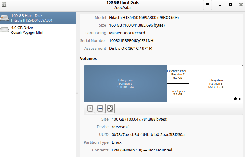

No, the problem is that when installing Q4OS on sda3, the extended partition on sda2 was obviously eliminated! It no longer exists. Still, both of my / home work correctly on both sda1 and sda3. I don't use a data partition because I have extremely little data on the hard disk.
When installing Q4OS, I assigned the sda3 to the installer. This also worked and Q4OS is installed on sda3 and is running correctly. Lubuntu on sda1 also continues to run correctly.
I therefore suspect that the installer deleted the extended partition sda2 and integrated it into sda3. That would of course not be very "nice" :-)
Yesterday I made the sda1 smaller again in order to install and test another Linux. Gparted did this correctly and named the new partition sda2. So it is clear that the extended partition was gone.
From the installation of Lubuntu I still had a swap partition, which I no longer use. It is 1.1 GB and I have now released (deleted) it. Can I define this space as an extended partition and then assign it to  sda1, sda2 and sda3? Then all 3 primary partitions would have the same extended partition. Does it work? I would need clear instructions, but haven't found any with google.
Attached is a print screen from GNOM disk with the status of my partitions. If you add all the volumes, the result is actually 160 GB, so it is not "hidden" :-)
No, attachment is not working. Maybe because I am new? :-) But there are 3 primary partitions and then the free space of 1.1 GB. Nothing more.

I think that I either overlooked an option in the installer that affects an already existing extended partition. Or if this option doesn't exist, the installer does something by default that it shouldn't. I didn't find anything about this in the installing instructions.
Apparently Linux doesn't need an extended partition. It's good :-). I just wonder how the extended partition disappeared during installation. It belonged to sda1 and I only specified sda3 for installation.

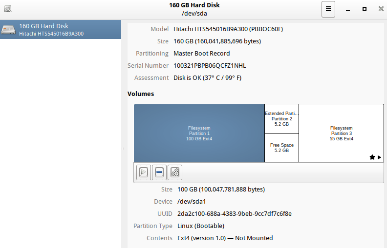

#11 2021-04-28 02:41
JSM
Registered: 2021-04-23
Posts: 81
Re: Extended partition deleted during installation
@Q4OS TEAM
Ok, I did the installation again, on sda1. I used the same ISO as the first time.

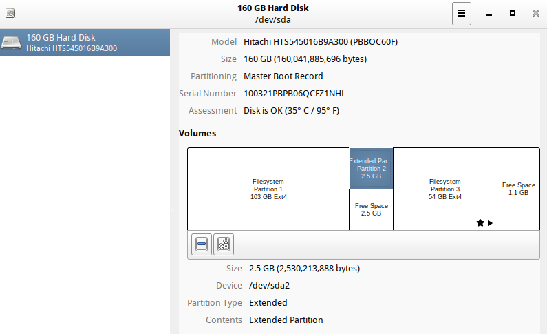

To create at least similar conditions, I first created an extended partition sda2, with gparted. See attachment "partition 1".
Installation information:
1. Classic install
2. Partition disk: Manual
     Only 2 partitions were shown, sda1 and sda3.
3. I chose sda1 and set it up like this:
Use as: Ext4 journaling file system
Format prt: yes
Mount point: /
Mount options: default
Laben: none
Reserved blocks: 5%
Typical usage: standard
Boot table flag: off
4. In the "last chance" window everything was ok, only sda1 operations were mentioned.
5. I refused Swap Space
The installation ran without any problems.
In the next post the results ...

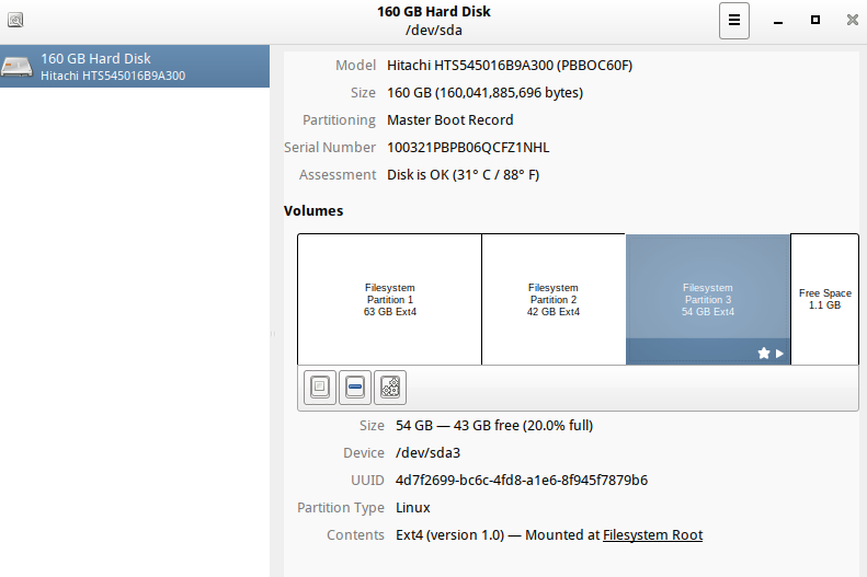

#12 2021-04-28 02:58
JSM
Posts: 81
@Q4OS TEAM

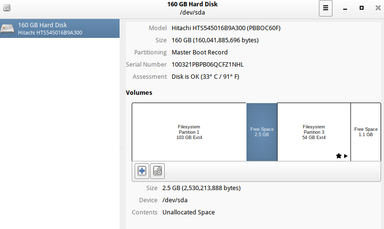

In the attachment "partition 2" you can see that the extended partition sda2 no longer exists and is only available as free space (2.5GB). So the same as with the first installation, you can see the free space there (1.1GB) on the far right. The free space was not integrated into sda1. I was wrong on this point.
Obviously, the existing extended partition will be deleted and converted into free space.
There was a second effect on the Grub2. The menu has of course been adapted. However, the entry for sda3 has been changed. The menu settings are also apparently overwritten. When starting Q4OS on sda3, a long list of commands came up first ... then it started normally and correctly. It would be better if the installer gave a choice of whether to install the grub or not. And when you install it, you should only create an additional menu entry, you don't need to change the settings.
Ok, I hope the test helps. I have now installed Q4OS 3 as base on sda1 and will expand it for myself. But first I'll wait for the answer in the other topic. Q4OS 4 has higher system requirements (1GB Ram). This is what i have. Maybe it is deeper with Trinity? That would be great :-)
have a good night :-)

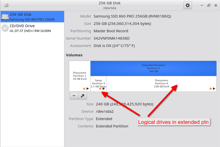

#13 2021-04-28 05:48
Posts: 1,383
You've created an extended partition, but by the look of it you have not then created a logical drive inside that partition. It is therefore ignored and that is why your installer only displays sda1 and sda3.

#16 2021-04-28 15:29
Posts: 1,383
JSM wrote:
@bin
You still don't understand the problem :-( The installer has deleted the extended partition. It does not matter whether a logical drive was created there or not. The existing extended partition must not be used, changed or removed by the installer, because it can belong to another installation, for example a Windows.
I think I see your problem.
Look at the attached and you'll see how gparted and gnome-disk utility display information about the same disk.
Using gparted the 2 gb ptn was created as an extended partition, but no logical drive created and so gparted shows it as Unallocated
Gnome Disk reads it differently and so gives the 'wrong' impression, but the installation process recognises the  gparted view of the disk - which is I think the more correct one.
Hope this helps.

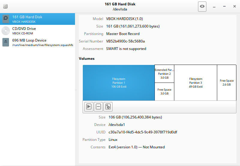

Posts: 81
@aluma
It's not what the installer can see, but why it removed the extended partition. An extended partition, created and formatted, is basically a special form of  partition with special usage. The extended partition, which serves as a container for logical partitions, can contain important data that is required by other operating systems. Therefore, the installer must not delete the extended partition even if it is empty at the time of installation. The installer simply does not have to touch the extended partition unless there is an option in the installer to use an already extended partition. I haven't found such an option. The installer only has to work with the primary partition assigned to it. Nothing more and nothing less.

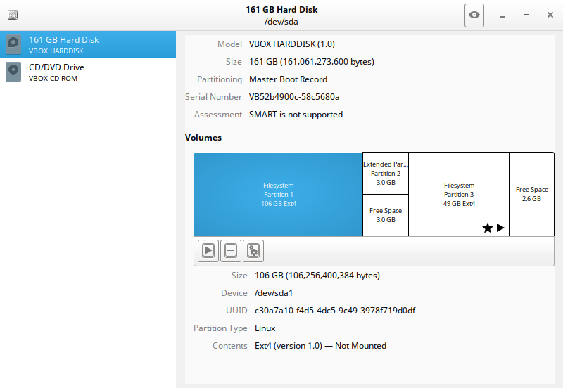

#20 2021-04-28 23:53
Posts: 4,791

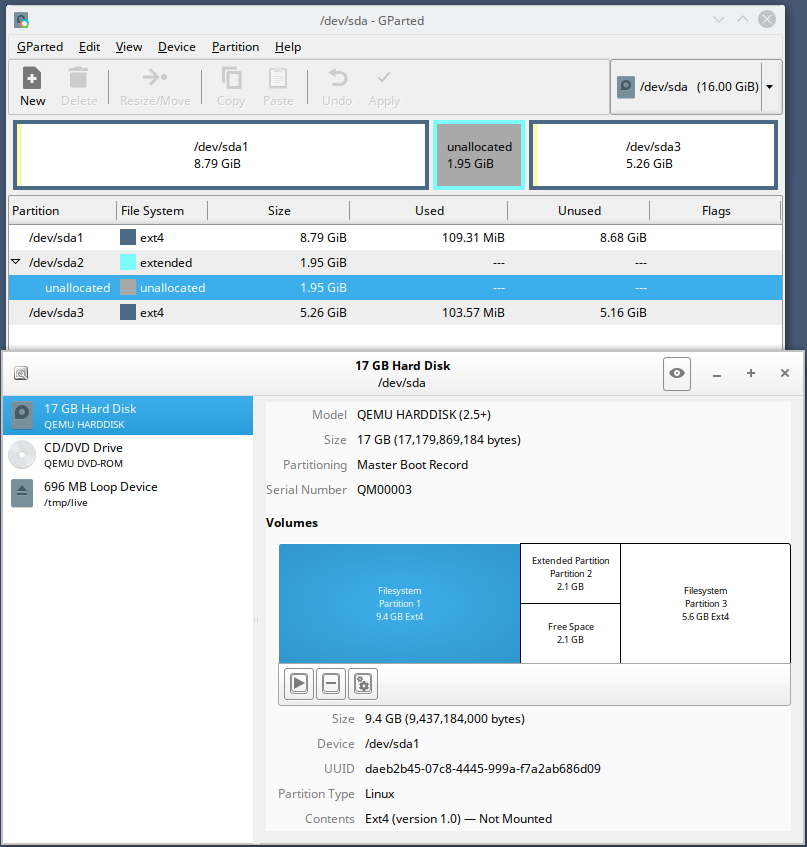

We are not able to reproduce the issue in Virtualbox. We tried to follow the steps above as exactly as possible.
- Boot live media and partition disk with Gparted, see the first image
- Install Q4OS from the "q4os-3.14-x64-instcd.r4.iso" media
- Use "sda3" for root ext4 filesystem, no swap
- Reboot to installed system, install "gnome-disk-utility" and check partitions
- Everything seems to be fine, see the second image
Would you suggest anything for us to reproduce the issue ?
Disk partitioned before installation:
The disk after installation:

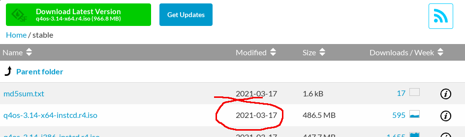

#21 2021-04-29 02:21
JSM
Posts: 81
@Q4OS TEAM
Well, I tested it again. And for whatever reason, this time the extended partition was not deleted.
I made exactly the same entries as in the first two installations. The only difference the third time was that I only installed the minimal version of Q4OS (Ultimatly minimal desktop). I used "Full" for the first installation and "Basic" for the second. Both times the extended partition was deleted.
I got the ISO from here:
sourceforge.net/projects/q4os/files/stable/q4os-3.14-x64-instcd.r4.iso
Apparently it was updated 6 hours ago, but I used my already downloaded version:
Modified: 03/17/2021 2:40 PM
I notice that the installer looks much older than in your instructions for the live version. The graphics of my installer are very simple, for example without the world map:
https://dai-trying.com/tutorials/instal … e-desktop/
I also looked for this problem on debian:
https://bugs.debian.org/cgi-bin/pkgrepo … t=unstable
I did not find a corresponding error, but at least two similar ones, which show that the debian installer does not always handle existing data carefully.

Ok, so the only difference with the third installation was the installed version "Ultimatly minimal desktop".
I can't give you any further information. And I guess I'm not trying to install it again. Three times must be enough :-)
Here the printscreen before the installation as an attachment. Unfortunately the quality is a bit poor. Ksnapshot or my screen settings?
#22 2021-04-29 02:22
JSM
Posts: 81
Here after (attachment)

JSM wrote:
... Apparently it was updated 6 hours ago ...
Why do you think so ?
The image has not been updated definitely. You can see image's upload date "03/17/2021" in the SourceForge repository. You can easily verify your downloaded image using md5sum hash. The official Q4OS installation images are never modified, only new images with new names are released.
