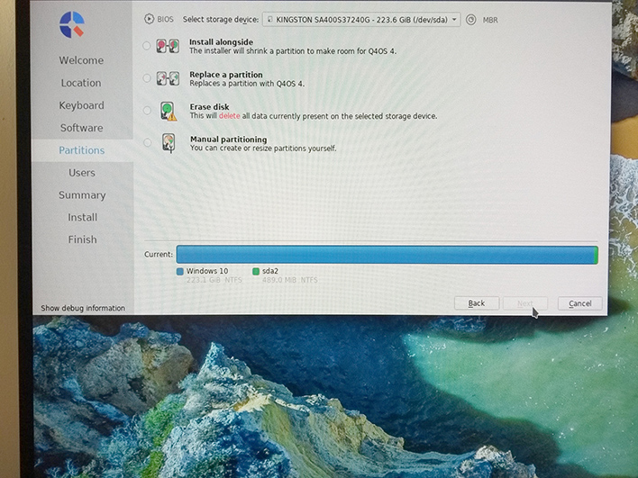

Its been a while since Ive posted nonetheless Im not totally new to Q4OS. I had Scorpion and now have Centaurus on an old laptop which runs like a dream on it. Therefore Im not a newbie but then im not an expert so wanted to ask a question with regard to installing Gemini on a PC that i use as a test machine but eventually want my 11 year old son to experiment a little and try and introduce him to Linux. The PC has two hard drives, a SSD with Windows 10 and a conventional hard drive that is partitioned into two. One partition serves as a data drive to store all the Documents etc...from the Win 10 OS. The other partition I want to install Q4OS on. My question how do I install Q4OS onto the partioned drive and where do i install Grub on the SSD ? Been a while since Ive installed linux so memory a bit rusty! Ive attached a image of the installation process i get to where im not too sure where to proceed to. Do i install using "install alongside" , "replace a partition" or "manual partitioning"? And where do install Grub again on the SSD with windows 10 on (MBR)? Sorry like i say its been a while since ive messed around with a Linux distro, so come to a blank!

Seeing though I havent had a reply as yet I decided to go ahead and install on the HD partition with grub configured to install on the MBR ssd (has win 10 on it) and just as I feared Q4OS installed on the hard drive but does not boot into grub just the SSD with Win 10 on it?! Any thoughts, like I say not a newbie but been a long time and being in my mid 50s my memory isnt what it used to be!

If your system is UEFI then you should point the grub installation to the EFI partition and it will add a boot option for Debian (and Windows) for grub, if on the other hand you are using an MBR boot system (BIOS) or using CMS option in UEFI then you should install grub to the main disc (i.e. /dev/sda)
Once installed either way after installing (and/or updating) grub you should have all the OS's listed by grub.

Dai_trying, Cheers for the info, its sort of confirmed what I was thinking but its not playing ball at the minute, will try a few things to work round the snags im encountering. Thanks again.
