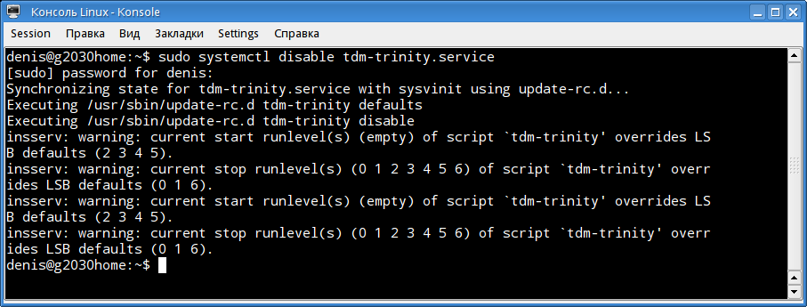

Got some warnings after executing command $ sudo systemctl disable tdm-trinity.service. Is it OK?

Yes it should be ok. You can check services status after reboot:
$ sudo systemctl status tdm-trinity.service
$ sudo systemctl status tdm.service
Only 'tdm.service' should be active.
