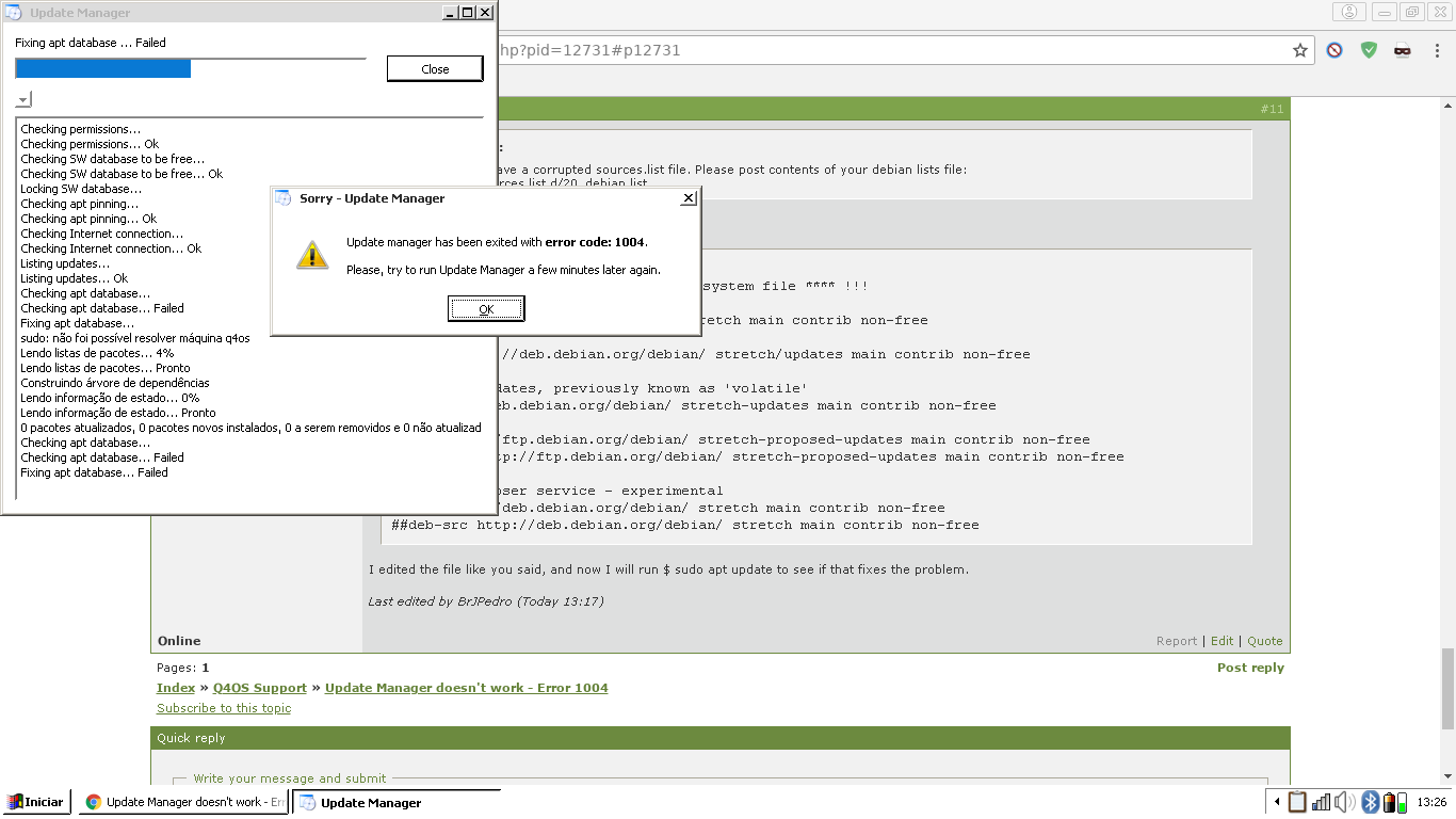

I tried to add the i386 architeture, but it fails yet. This is the screen error:

#11 2018-04-21 17:13
BrJPedro
From: BR
Registered: 2018-03-20
Posts: 75
Re: Update Manager doesn't work - Error 1004
It appears, you have a corrupted sources.list file. Please post contents of your debian lists file:
$ cat /etc/apt/sources.list.d/20_debian.list
Here it is:
# Q4OS essential repository
# **** !!! NEVER touch this CRITICAL system file **** !!!
deb http://deb.debian.org/debian/ stretch main contrib non-free
deb-src http://deb.debian.org/debian/ stretch/updates main contrib non-free
# stretch-updates, previously known as 'volatile'
deb http://deb.debian.org/debian/ stretch-updates main contrib non-free
##deb http://ftp.debian.org/debian/ stretch-proposed-updates main contrib non-free
##deb-src http://ftp.debian.org/debian/ stretch-proposed-updates main contrib non-free
# mirror chooser service - experimental
##deb http://deb.debian.org/debian/ stretch main contrib non-free
##deb-src http://deb.debian.org/debian/ stretch main contrib non-free
I edited the file like you said, and now I will run $ sudo apt update to see if that fixes the problem.

#12 2018-04-21 18:42
BrJPedro
From: BR
Posts: 75
$ sudo apt update now works like a charm.
But Update Manager not. :'/
joaopedro@q4os:~$ sudo apt update
sudo: não foi possível resolver máquina q4os
[sudo] senha para joaopedro:
Ign:1 http://dl.google.com/linux/chrome/deb stable InRelease
Atingido:2 http://dl.google.com/linux/chrome/deb stable Release
Ign:3 http://ftp.debian.org/debian stretch InRelease
Atingido:4 http://security.debian.org/debian-security stretch/updates InRelease
Atingido:5 http://ftp.debian.org/debian stretch-updates InRelease
Atingido:7 http://ftp.debian.org/debian stretch-backports InRelease
Atingido:8 http://ftp.debian.org/debian stretch Release
Atingido:9 http://q4os.org/q4repo q4os-2-0-cn InRelease
Atingido:11 http://q4os.org/qtderepo stretch InRelease
Lendo listas de pacotes... Pronto
Construindo árvore de dependências
Lendo informação de estado... Pronto
All packages are up to date.
joaopedro@q4os:~$
Update Manager:
João Pedro -o- @12h01
#13 2018-04-21 18:53
Posts: 2,989
Could you install inxi and post the output of
inxi -rS
and also post the output of
cat /etc/hosts
EDIT: and have you rebooted your machine at all? if not could you reboot and check updater again?
