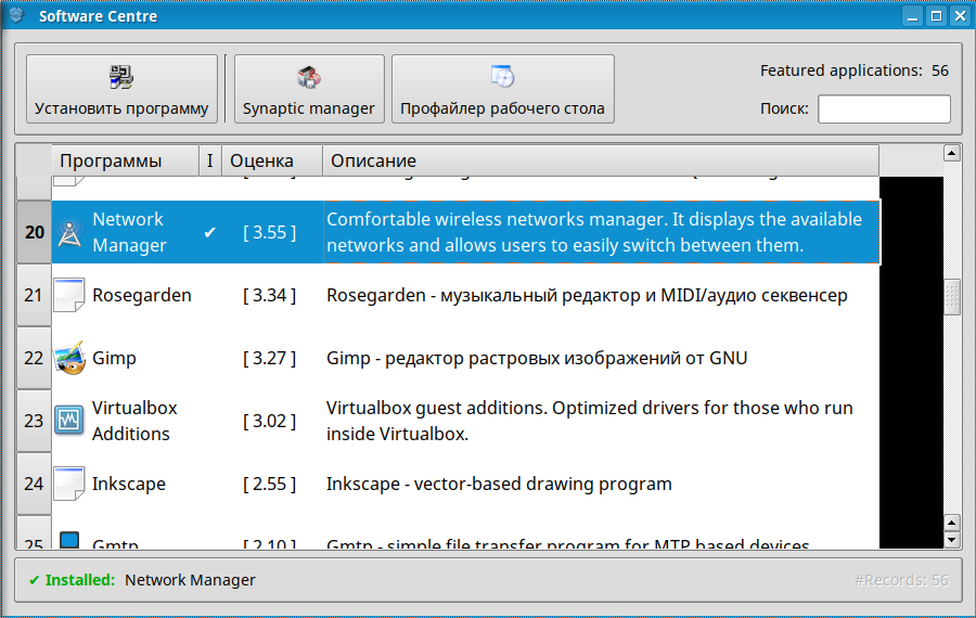

So, the first thing, try to install the Network Manager using Q4OS Software Centre (see attachment). Sometimes, it is enough to solve the WiFi problem, because the default TDE Network Manager does not working well with WiFi Adapters.
If it does not help, read this forum topic: https://forums.debian.net/viewtopic.php?t=135638
And try the solutions, described there.

#7 2023-09-12 09:08
acerspanish
Registered: 2023-08-25
Posts: 9
Re: TDE Network Manager connection attempt failed SSDI not found! [SOLVED]
Hello Rademes, you are a genius, Now I could connect to the wi-fi using the first oprion you gave me. I installed the Network Manager using Q4OS Software Center, after restarting the laptop, IT WAS POSSIBLE to connect to the wi-fi. I think we can close this thread now. Thank you very much again, you have helped me a lot.
