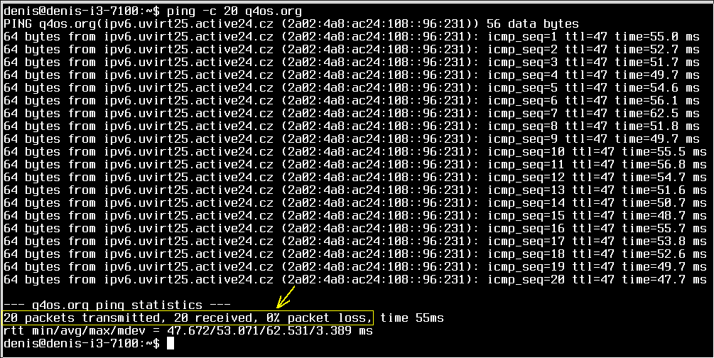

Please run in terminal these command sequence, and post output here as text file:
inxi -Fz && ping -c 20 q4os.org && cat /etc/apt/sources.list.d/10_q4os.list && cat /etc/apt/sources.list.d/12_qtde.list && cat /etc/apt/sources.list.d/20_debian.list && cat /etc/apt/sources.list.d/30_debian_backports.list
This will give us system information, checks your internet connection and shows your repository files.
Normally, the second command should return the output from attachment.

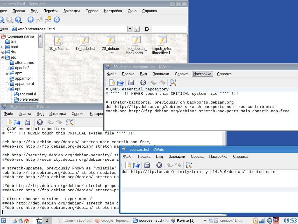

URL, which the apt requests are indicated in  these files.
You may have a different version of debian and Q4os.
But are they correct?
