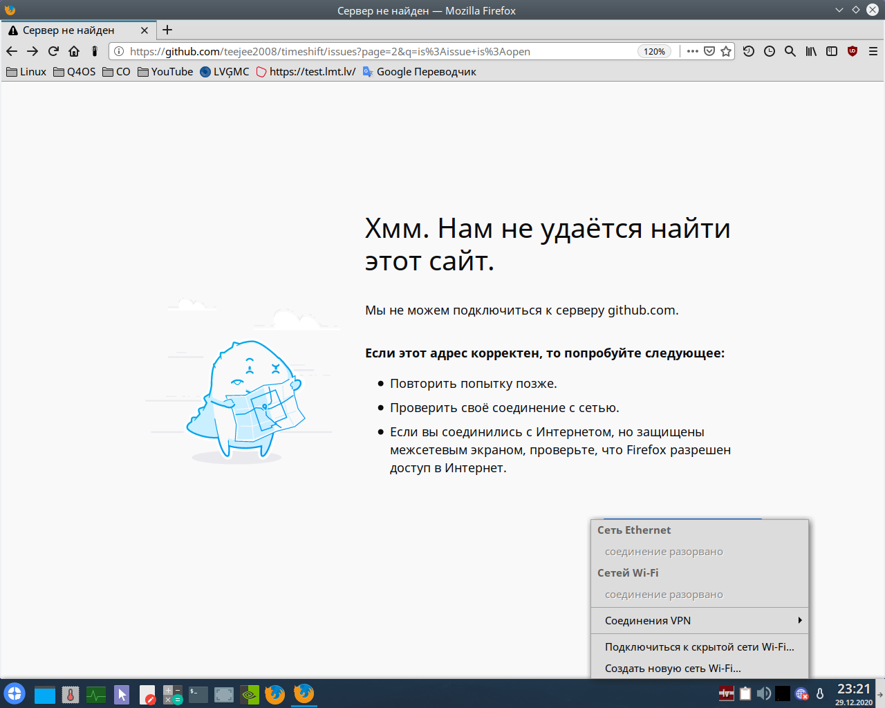

For some reasons my WiFi randomly disconnects. No warnings, no errors. Just disconnects, and Network Manager does not show SSID of my network (attachment). I have to reboot my PC to reconnect again.
I have tried to install Network Manager from software centre, disabling IPv6, disabling power saving...no results...
Please help, this is very annoying, especially when you do important work using Internet, WiFi disconnects and you have to reboot your PC to connect again.

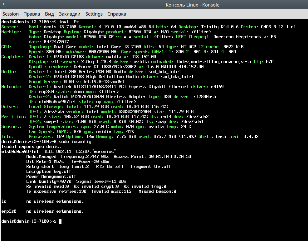

The iwconfig is a bit of a puzzle. At the time that was done had wifi dropped off? If so it would be interesting to see one when it is working normally as a basis for comparison.

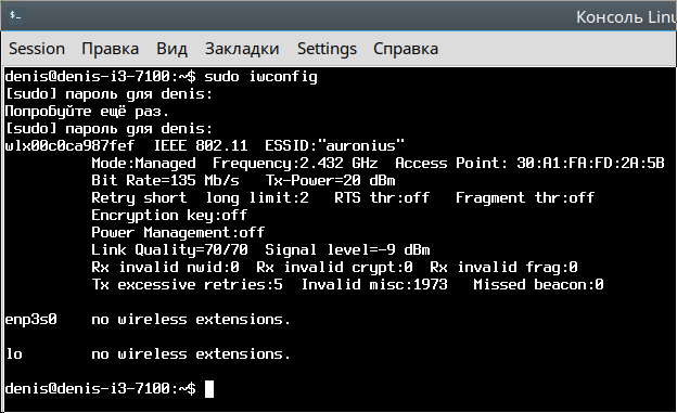

iwconfig is shown on working WiFi connection. I have done this screenshot while reporting this issue. In attachment is another iwconfig on working WiFi. Sorry for wrong screenshot name.

Given this is a desktop I am puzzled by the figures in the 2 iwconfig screenshots
The first one shows a bit rate of 1Mb/s and signal level of -11dBm
The later shows a bit rate of 135 Mb/s and a signal level of -9dBm
The signal level is almost impossibly low unless your router and dongle are practically touching - which they probably are not. I have no explanation for this - typically anything around -30dBm is fine.
I sort of get the feeling that the connection is trying to go too fast for whatever reason and eventually just going wrong.

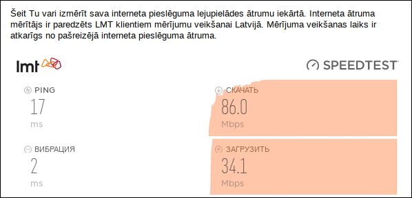

Yes, my Internet Provider decided to give us a New year gift. It made its Internet faster than usual (15-40Mbps), but now it is as you can see in first attachment.

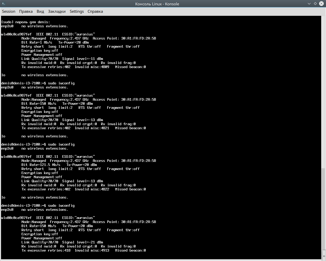

But iwconfig still change its values. When Firefox is closed it shows 1Mbps, When I run Firefox and browse it shows 121Mbps and even 150Mbps (second attachment). But it never caused problems earlier. Also my WiFi is capable to run at 150Mbps, according to its specifications.

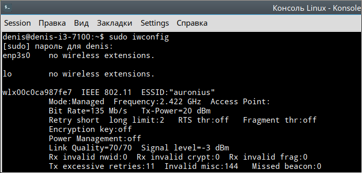

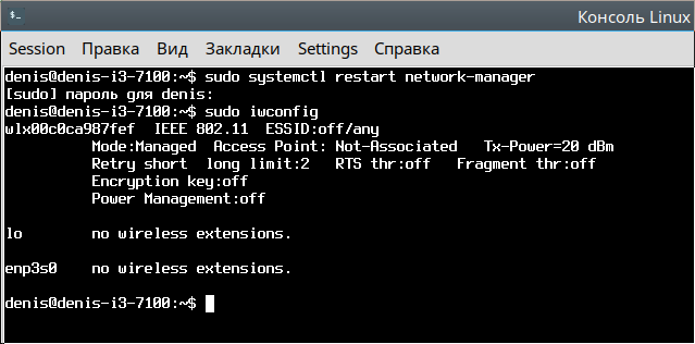

Unfortunately, your advises did not solved my problem... WiFi still disconnects randomly. Here is iwconfig after wireless has been disconnected.

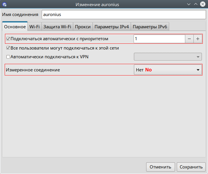

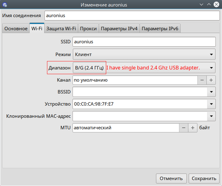

I have moved my WiFi USB adapter farther from computer system block (case) and made some modifications in Network Manager (attachments). Now my WiFi does not disconnects anymore. smile
