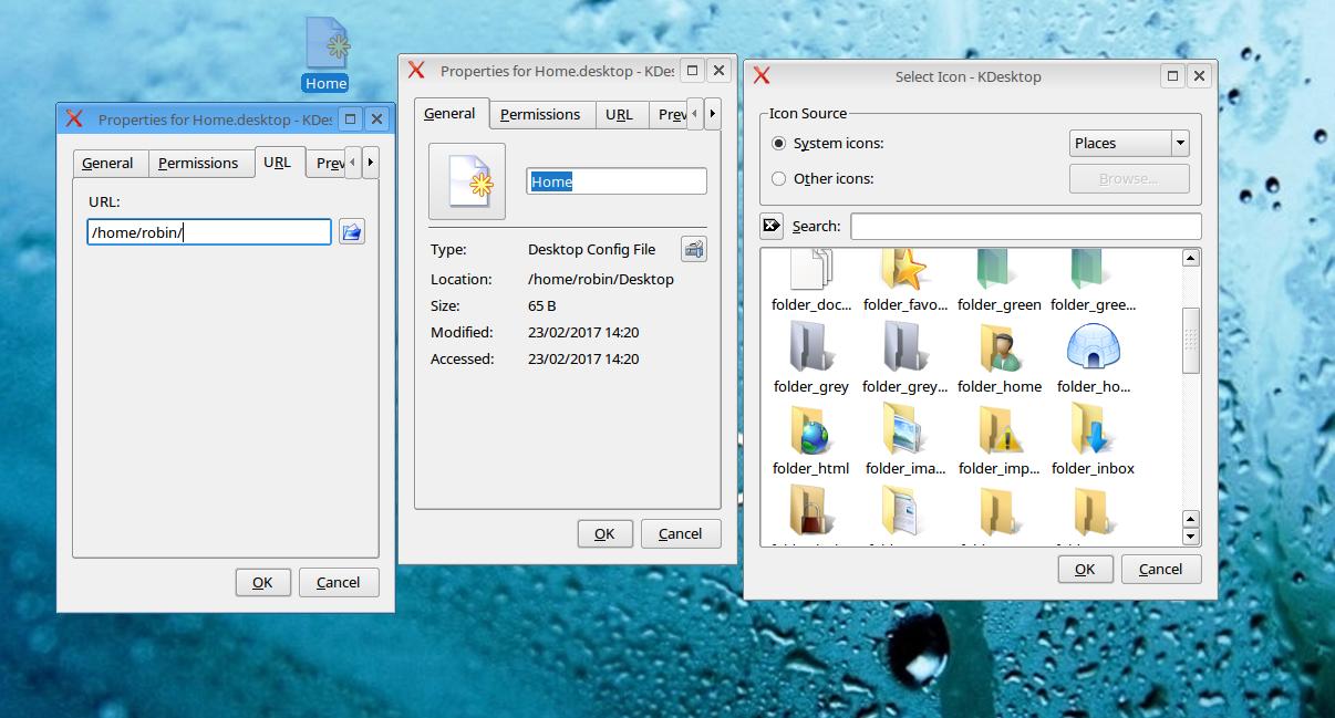

For me would be perfect (also) a link to "Home Folder" on the desktop - because beside "Documents", i've got there archives, programs, utilities and so on - i think i'll create such an additional shortcut to my desktop.
That's simple enough. Just right click on the desktop
Create>New>Link to Location
Location Name>Home Folder
URL /home/yourusername/
OK
Then right click on the new blank icon>properties> click the big icon then use the drop down list to go to Places>select a suitable icon
Job done.
The first time you use it it may open the system:/ box - so as you know just select the Home Folder icon down the left hand side and it will behave as required.
As an alternative, right click on the taskbar at the bottom>Add applet to panel>System Menu
That will allow easy access to Home and Documents
An alternative and I find very useful applet is the Quick File Browser - this allows quick and easy access to all your files from a single icon on the taskbar/panel
Job done.
Thanks again - i already did this!
But, can i change also the icon for a link (on the desktop) to other filetypes , like .sh (scripts) or executables?
i've got a link to a specific "run-Firefox.sh" script on the desktop, but right-click -> Properties offers no possibility to change the shown icon ?!
